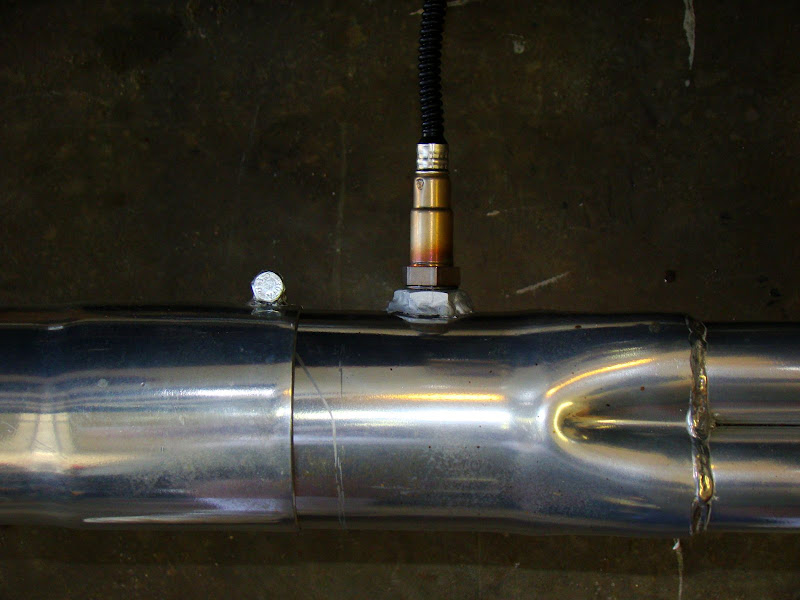

not mine but here are some pics.
they are of totals tangerine t
referencing the above pic, keep in mind that for better 0-2 sensor life it should be installed with the connector end pointed up at at least a 15-20* angle. otherwise condensation can collect in the sensor head and shorten it's lifespan conciderably.
Also wouldn't hurt to install it a couple inches further downstream for better cylinder "averaging" IMHO.
.02,
Russ

Grant, how about re-posting that photo of your O2 sensor in the header.
