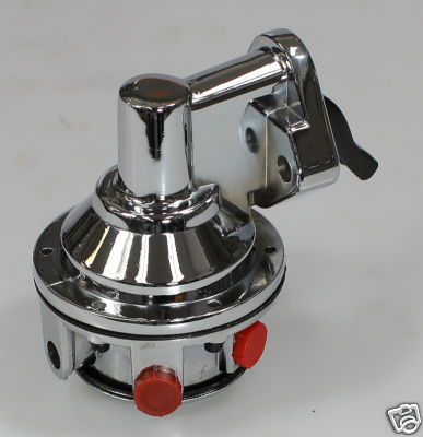

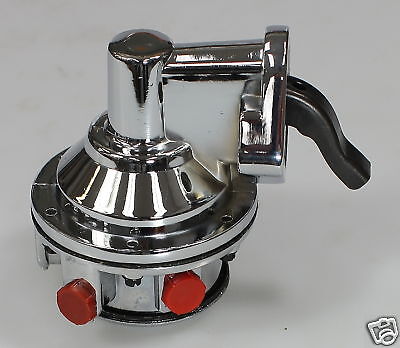

Hey Lee. Here is my fuel pump. Yes, as i recall the previous owner of the carbs did tell me he was running them on a blower.
EXTREME SERIES HIGH VOLUME CHROME MECHANICAL FUEL PUMP FOR SBC CHEVY ENGINES. 150 GPH
This fuel pump is the ideal size for most street/strip applications. It is what we recommend with most of the engine buildups we sell.
Fits most all sbc small block Chevy engines requiring a mechanical fuel pump.
This fuel pump has 1/4" NTP inlets and outlet.
  • High Output Fuel Flow
  • Shutoff Pressure Pre-set 8.0 PSI
  • Fuel Pressure Regulator is Not Required, but recommended.
  • Heavy Duty Construction For Continuous High RPM Operation
  • Fuel Body Casting Can Be Rotated to Accommodate Various Plumbing Situations
  • Inlet & Outlet Tapped For 1/4" NPT
THIS FUEL PUMP HAS A RETAIL VALUE OF $69.95
This fuel pump has a lifetime warranty, and we will back it up 100% regardless of what type use or mileage. This pump is heavy duty rated for street, strip, or off road use.
Extreme series fuel pump for most all small block Chevy engines. This pump has a 150 gallon volume at 6 psi. At wide open throttle this pump may run a max pressure of 7-8psi. This is the fuel pump you want for high hp street or strip applications from 200-450 hp. The fuel demands under wide open throttle on an engine are very high, especially those with large cfm carbs. Never would you want to run a stock fuel pump on an engine that has been built up to any degree. Remember, most stock Chevy engines produced around 180-210 hp. The oem style fuel pumps were designed to accommodate a very low fuel demand.
Fuel pressure should be regulated to between 5 and 6 psi for normal driving. Off-roading might require less pressure, while all out drag racing might require 6-8 psi. Too much fuel pressure can cause the carb to run rich at low speeds, while too little fuel pressure might cause the carb to run lean during high engine speeds and loads. It is our recommendation that you run a fuel pressure regulator and gauge to set the pressure where it needs to be. The regulator will keep the pressure much more consistent, and eliminate problems caused by to much or to little pressure.

Your fuel pump specs out at 6-8psi. Edelbrock carbs don't "like" pressures that high, more like 3-1/2 to 4-1/2 is more realistic for them.

Check your fuel pressure before you go any further. Sales ads don't tell anyone anything. If that ad is anywhere close to being accurate, you obviously have a pressure issue. For the record, a friend from this division we used to race with now does a lot of carb work. His customer list reads like a who's-who of National Champions and record holders in Pro Stock. Allow me to quote from his most recent newsletter -
Make sure that your regulated fuel pressure is set correctly. Depending on what size needle and seat that you have, you should be anywhere from 4.5 psi to 6 psi. Never run any higher than 6 psi.
Emphasis mine. Remember, you are not only relying on the needle and seat closing off properly, but also the action of the float working with it.
In nearly all applications, 4.5 psi is going to be more than adequate. As long as you have enough incoming pressure to overcome the float, you have adequate pressure. 6 psi doesn't make any more power than 4 psi. And if you have any more than 6 psi on those Edelbrock carbs, you're flirting with disaster.
Pull the dipstick and give it a good whiff. Smell any gasoline odor? What's that telling you, other than you're flooding the cylinders with more raw fuel than they can handle? And if you do smell gas, add an oil change to your list of things to do.
