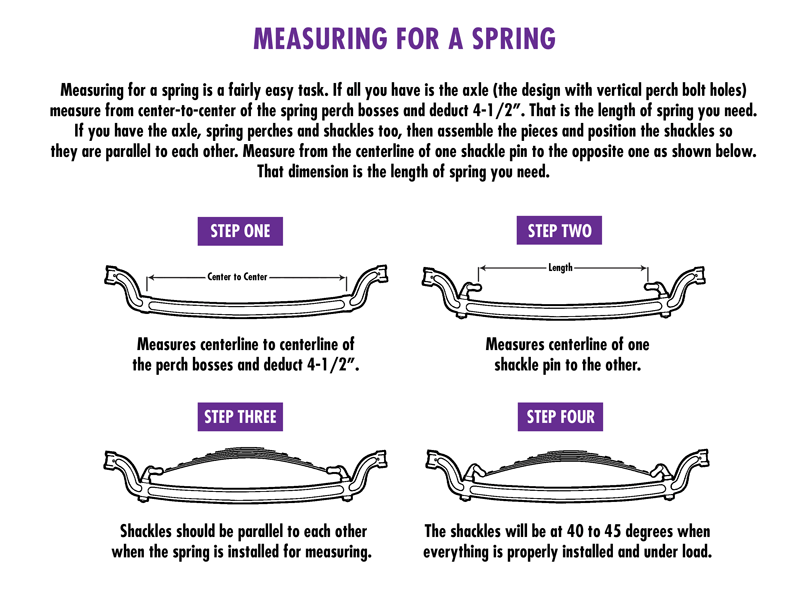

Speedway has an excellent guide how to figure out what spring you need... This works for tube or I-beam axle...
Al that is the chart I used to get my measurement , I jacked up the frame till shackles where level like in step 3 and measured from eye to eye and got 34 3/4 ,,

man oh man... that is not off the shelf for sure... Someone must of had a spring from something and made your front axle to suit it... There are places that will build you springs to your spec, but I'm sure it will be more than Mr. Roadster or like... Have you checked around your area? I talked to a place in Seattle that all I had to do was bring my T by and they'd build me a new spring (rear) but I decided I really didn't need a new one... I just cleaned it up and reused it... one of the few parts I kept! :o

Rockn T , your front axle assembly is from a '35 to '40 ford. the spring in front of the axle is why you can't find the spring you are looking for. there are spring available from posies with reversed eyes and slider buttons.
Lucas1923T, your front spring should be 31" eye to eye. my suggestion would be to get the reversed eye spring, a new set of shackles and spring perches from speedway. you can also lose the dampener. onece the car is completed you can play with the adjustments and it won't be needed.
