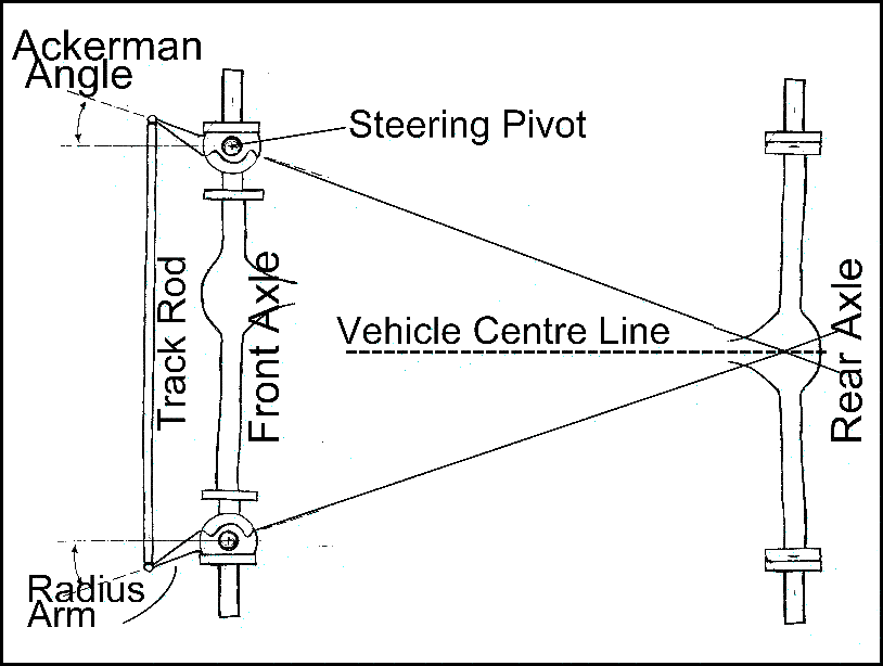

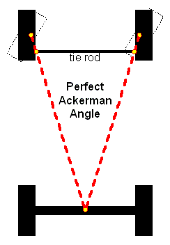

I'm going to run my tie rod in front of the axle. For proper ackerman, arms in that shape are an automatic decision. My first T had the proper arms and the rebuild didn't. It was like night and day. For one, without those arms, my turning radius was about 30' and I'm being conservative. I never measured it, but I experienced it.
Thus:

Here is a picture of my homemade steering arms for a front mounted tie rod. They allow me to have perfect Ackerman.
That looks perfect, Jim.
