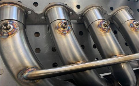

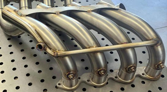

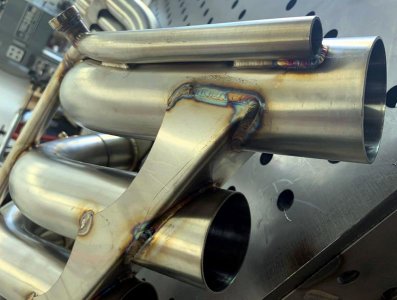

Is that because of difficulty locating the bung for the oxygen sensor? Checkout this thread . . .
o2 sensors are used on zoomie headers all the time now on NHRA Pro Mod cars. A tube is welded on the back side of the zoomie that connects to each of the 4 tubes and there is a bung welded on the tube for the o2 sensor.
