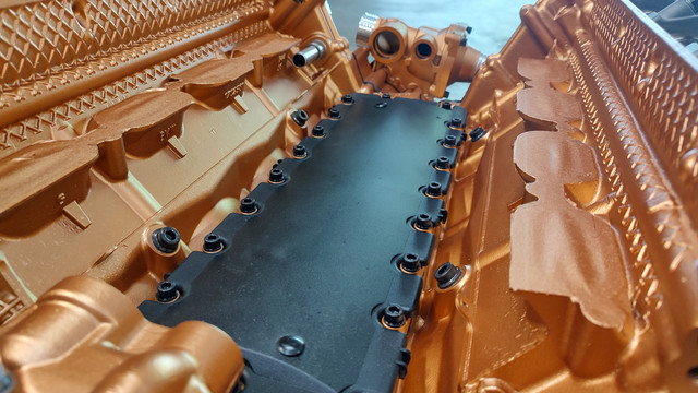

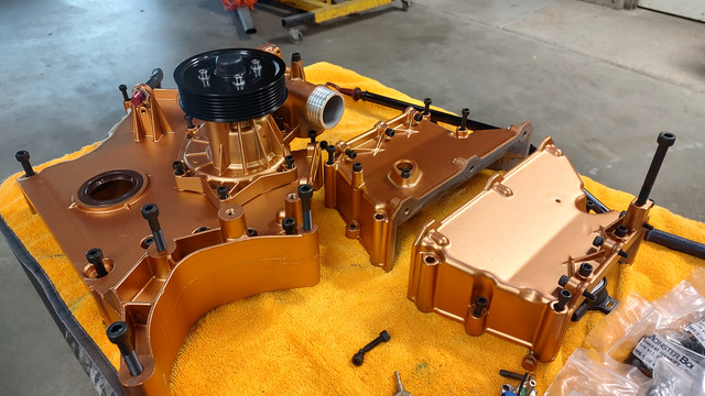

Continued to paint stuffs. Painted a valve cover silver. I like it so much more in person I'll run with silver valve covers for now. I can always change them later.
I told myself I wasn't going to do this entire engine in black oxide socket cap bolts. That didn't last very long.
The black oxide bolts tend to eventually rust. So I soaked each bolt in oil for a bit then cleaned off, we'll see if that prolongs the inevitable.
