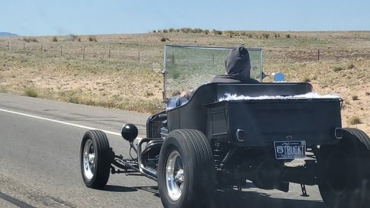

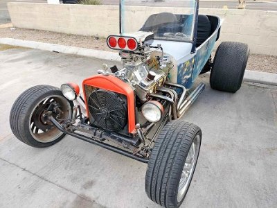

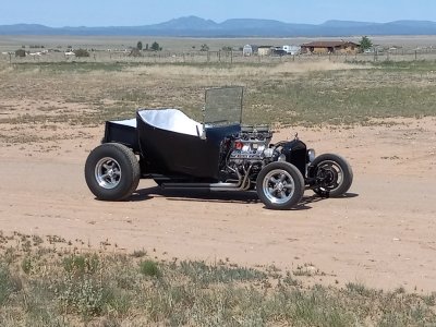

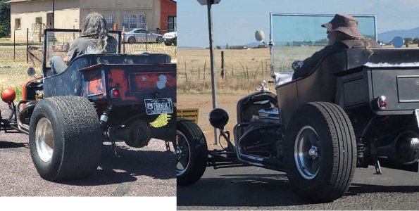

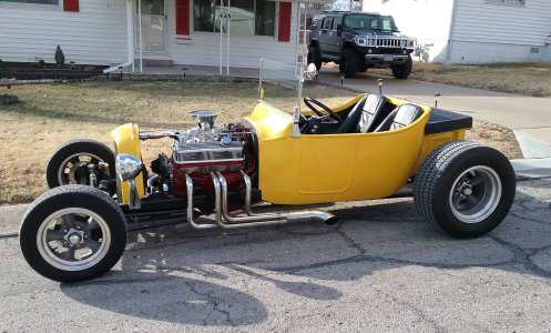

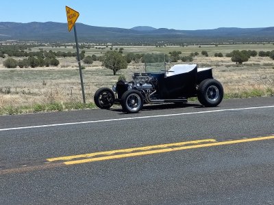

So, a bit of a description. Speedway front brakes, unknown (speedway?) front axle and hairpins.

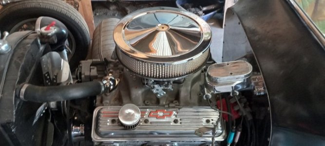

Frame is an OE channel, boxed, cut, kicked. ZZ3 crate engine from 1989, it's been worked over, but no solid info from seller.
Hughes TH350 with a manual valve body, fairly low stall converter. 49-51 Olds rear axle with arms, diff is from a 52, 3:42 ratio.
Kia Rio rear coils (light) replaced the huge previous springs. 46-48 Plymouth rear shocks replaced the Harley coil-overs.
Ford F1 steering box, Chevy steering arm connecting to drag link. T wheel.

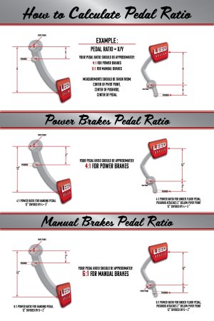

Modern vette style master on firewall, 5:1 ratio pedal, no booster. Takes a firm push!

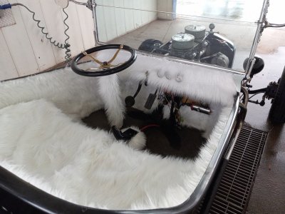

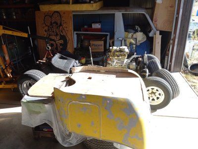

Old body with card 'glassed in but faded to all white. Sanded down and primed, will need some work and blocking before paint. New floor, old stuff was a cobbled mess. Previous paint on body does not match paint on shell, lights or bed (all were Orange).
Basic headlights, 51 Chevy PU tail lights, Junk gauges and switches, flat dash.
Lots of improvements to come, but will not be a show rod.
