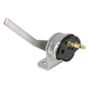

One common way to mount the brake light switch is to put it in the line to the rear wheels somewhere between the master cylinder and the first drum/caliper. Lots of people sell little inline fittings to hold the light switch. As far as air in the line, if the brakes are rotated so that the bleeders are not at the top of the backing plate / caliper a pocket of air will remain above the bleeder. To bleed brakes I've always used a vacuum system that runs off my air compressor and that gets the air out every time.
