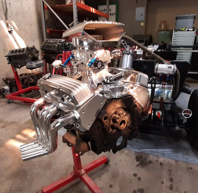

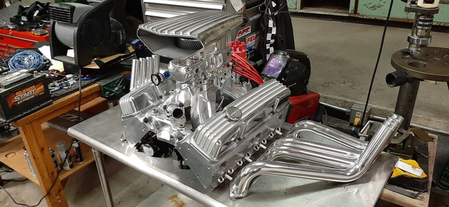

The first part found that sparked this project is the Polished Holley Strip Dominator single plane intake manifold, acquired from an estate sale. The Demon 750cfm annular booster carburetor was found on the back pages of Holley's website as a factory refurb.
The attention grabbing carb soop is an Arias "Viper". The cylinder heads are a placeholder for now, they are cheap chinese EBay bare aluminum heads that I may... or may not invest the grind and clean up time to run them. I dream of a set of AFR's or Trickflows.

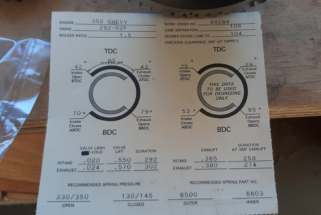

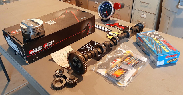

The cam choice is a Schneider Racing Cams solid flat tappet 292-02F, 292°/302°-104°ICL/106°LSA. .550"/.570"
The pistons are Speed Pro H617cp's, 1.560" pin/compression height and +11.8cc volume

With 64cc chamber cylinder heads the static compression will land at 12:1 with these pistons. Running that schneider cam the dynamic compression will be around 9.1:1. I have no idea if the the valves will clear the pistons until I can clay the chambers on mock assembly

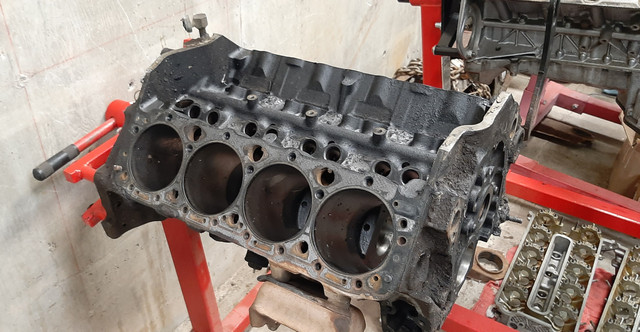

The block is recently acquired and it's not quite the correct puzzle piece I was looking for. The block is a Vortec era 880 casting, 2bolt still in 4.00" bore. One piece rear, roller cam provisions.
I am still keeping my eyes open for an older 4 bolt 2 piece rear SBC block that I can clean up at .040", but the vortec block would work. It just feels weird running a solid flat tappet cam in a roller block and I'm not looking for the added expense of the roller set up, albeit worth it.

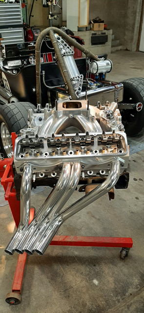

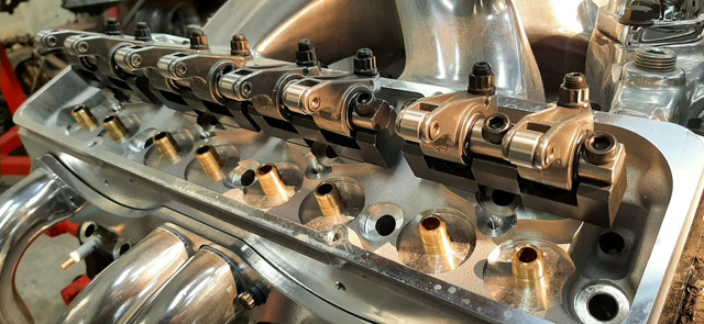

The oddball parts for this engine build that I don't have previous experience with are the pedestal mount shaft rockers for the SBC. I saw them in a catalog and really liked the idea of getting away from rocker studs. So far I can tell they won't clear head studs.
The zoomies are from speedway, these are the ones that guys flip upside down because they won't clear any kind of frame. They are 20" between the banks at the narrowest. I would need to narrow a frame to make them fit.

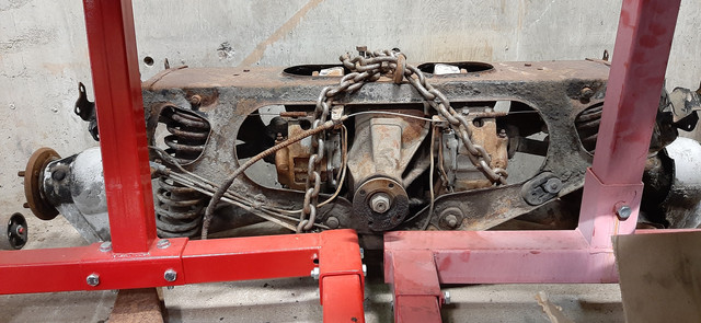

The only component thus far for the "Car" side of the project is a Jaguar IRS differential
