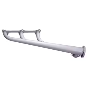

I like how lake-style headers have that extra output and flange on the end. I thought maybe I could do that and then pipe things to a muffler under the car (if there is room):
But I don't really like the look of those headers. I like the long tube side exhaust style much better. But none of them that I've seen have that extra flange on the end.
You can always add the extra flange and block off plate.

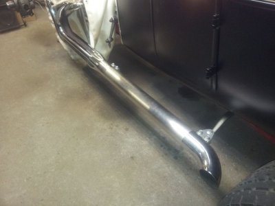

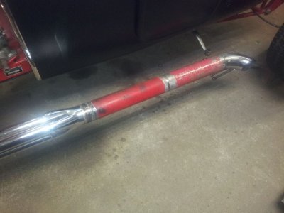

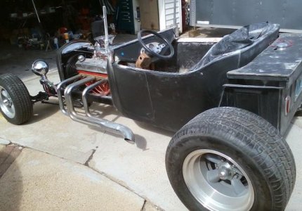

I didn't like how loud my 454 was...so I trashed the little muffler baffles and used two 2" glass packs per side. I cut them up and made long, single mufflers from them. Welded them to the collectors of my sprint style headers and wrapped them in brushed stainless sheet. I welded the cut off tips of the original muffler setup to the ends for the right look and made hangers from some old lever shock arms to keep the weight off the headers. The 4 welds were ground and hidden with stainless band clamps, which also served as a mounting point for the rear hangers. Worked great! I liked the sound...and although it wasn't new car quiet, it was mellow and deep until you got on it.
Awesome ingenuity, resourcefulness and result! This is what hot rodding is all about, to me anyway!

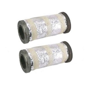

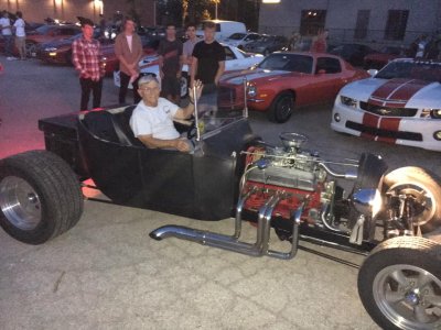

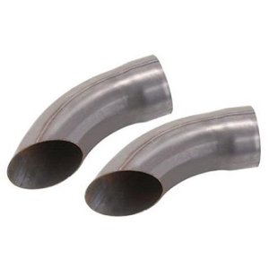

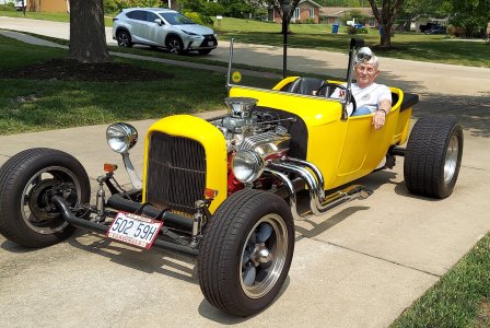

I went a simpler route with mine. I used the short Speedway muffler inserts shoved into my collectors with a shorty turnout. No stress on the header welds, and not too noisy. Never had a noise complaint anyway . 🙄 But . . . it doesn't have the nice deep tone that Hackerbilt does either.

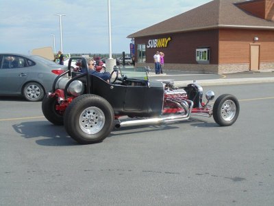

Most t buckets use headers like what Spanky is showings above in his post. Installing inserts is about all you can do. Depending on the amount of room with have, you could be different and run your exhaust conventionally out the rear. Using block hugger headers, you could run exhaust tubing underneath the body. You can then use more conventional mufflers. This will not only quiet the exhaust for your neighbors but for you too. Part 20 in Tbucketplans.com shows this on a 27‘ T.

I'm currently looking to purchase some classic swoop style headers (Ford 302)...similar to Spanky's. Is there a preference on what brand to use (Speedway or Patriot headers)? Also, is it better to go with AHC or Stainless? If I went with Stainless headers, do they even sell stainless kickoff extension pipes to match the headers? I'm not seeing anything at Speedway or elsewhere. I guess you just buy the chrome or AHC extensions and mix it up with the stainless headers? Any insight or helpful input would be appreciated.
