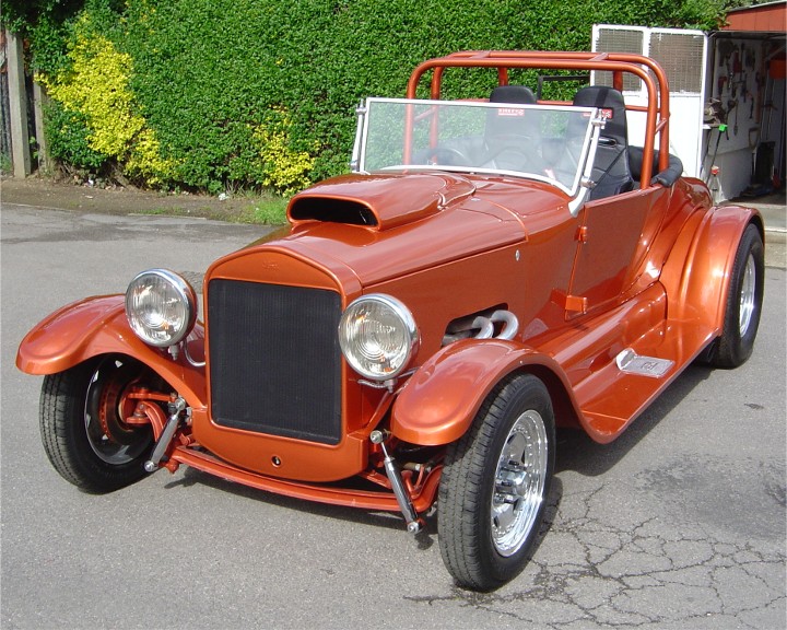

Here's an example of what I was thinking of in terms of a roll bar. I realize this is not the same as the '23 T body. It would have to be a little different. My only concern with a roll bar is you can kill yourself with it if you hit your head on it in an accident. This is certainly something that would take careful planning.
My bucket will have a roll bar... Of sorts. It will mostly be a place to mount the stacks, (Think Peterbuilt my buckets more truck then car)
It will look like a light bar you see in the back of a pick up. I bent it up from heavy wall tube 1 3/4"X.093, it's welded to the frame and would support the car if needed (Lets hope it's not) It also has a cross bar that will allow me to ad shoulder belts and head rests, as well as being the main support for the top. May even go with four point harness.
