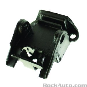

I'm starting to plan for mounting the SBC to the frame (it is getting exciting! I'm hoping to have some pictures soon). I went to the auto parts store and found these:
Has anyone fabricated a bracket for the frame that works well with these? If so, I'd appreciate some ideas on what that looks like. Or, is there a different style that works better?
I have used those. There are a lot of options out there so it’s just a matter of taste.
Thanks. Is the rubber part in these sufficient for dampening vibration? Or is there supposed to be some dampening on the frame bracket too (like the clamshell mounts)?
I'm using those and they work just fine. My frame brackets have no damping feature - basically just a piece of tubing welded to a section of rectangular tube which is welded to the frame. A bolt passes through the "ears" on the motor mount and through the tube on the frame.

You don’t need rubber but yes, the stock ones with rubber are sufficient for dampening vibrations s, that’s all they use on cars, well, the transmission mount is rubber too.

I wouldn't use that particular rubber mount-- it doesn't have the safety fingers.
Ask me what happens when it breaks.at full throttle!
If you're using a stock style mount go with the one for a '69 Camaro z28 with a 302. They have hooks on them to prevent failure due to engine torque.
