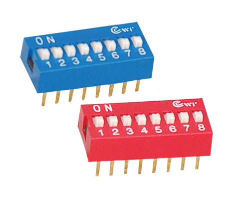

The worst calibration routine I have seen is on the Dolphin speedometer. It has something like eight dip-switches in the back of the speedometer that you have to flip on and off in various combinations until you get it right. I never did get my Dolphin speedometer anywhere close to right (don't get me started on Dolphin instruments! :foottap: )
Here is a dip-switch...
