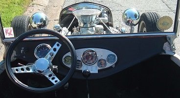

Looks like we didn't directly answer your question, except for 409T. I tried using the cable for my TH 350, and ran it thru the top of the transmission hump and back to the cable entry port. Gearing was wrong and I drove for awhile with an RPM/MPH conversion chart taped to the dash. Finally went the GPS route and am a happy camper. Works flawlessly and gives me the correct speed reading at all RPMs.
