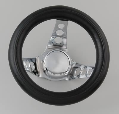

What type are you lookin for flat dished how much?
I'm not a fan of using the original T steering wheels, but if that's what you want, ebay is the best place--there is over a dozen of them listed at all times. As for "hot rod T" wheel, you should be able to find plenty of cheap used ones at swapmeets, or new ones there as well or speedway has a good selection of them (heck even autozone carries some). If your column is a chevy style, you'll probably need the grant universal 3 bolt steering wheel adapter.
Also what diameter and dish? Depending on your seating arrangement and column length/angle it will make a huge difference. I mocked mine up with an old junk gm wheel with some dish and depth. My final wheel was a flat (no dish) bell style wheel and it was not quite right at first. I ended up having to buy a longer and much more expensive steering wheel adapter to compensate. Mock it up with the wheel you are using or a similar one!
