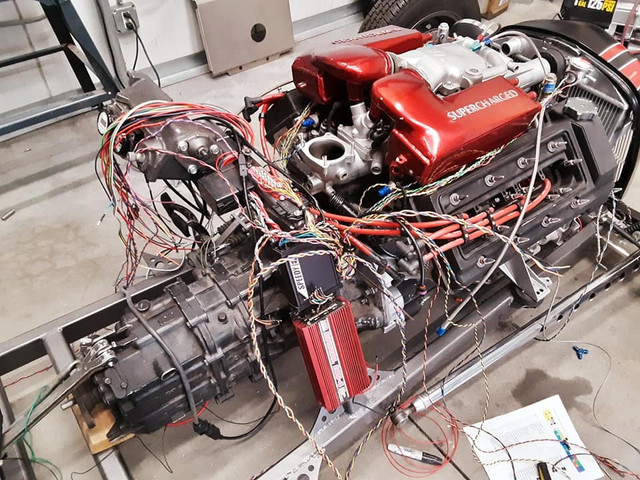

Modifying the aftermarket 90's mustang 75mm throttlebody to bolt down to the jaguar supercharger inlet

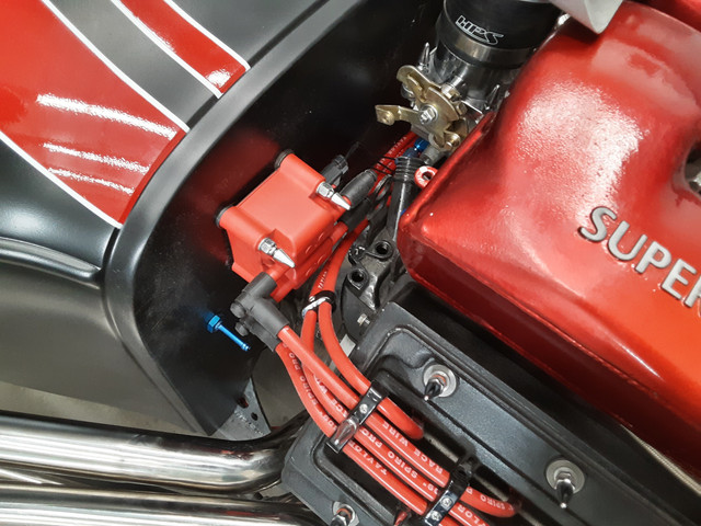

Mounting ignition coils and making the ignition lead ends/terminals.

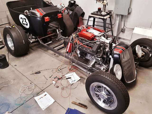

At this point I'm really feeling like I'm trying to stuff 20lbs of stuff into a 5lb bag, It's already getting tight to mount everything
That's T-buckets for ya' ;) Not a lot of room for anything/anybody!:confused:
Your t bucket is lookin' great mykk. For my boat seats , I used jeep sliders & black abs plastic to make an adapter. Don't forget ; I have 10"s more leg room than the standard t bucket. Hopefully , 6' + people will be able to drive the car too.

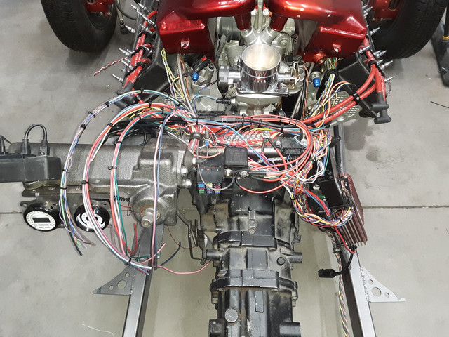

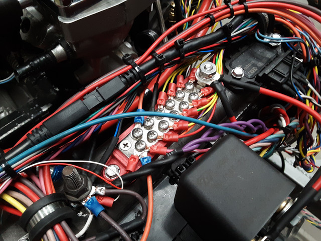

Man that's alot of wiring .... I love it !!!
Looking very nice and neat!
