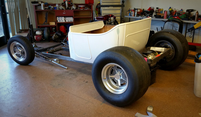

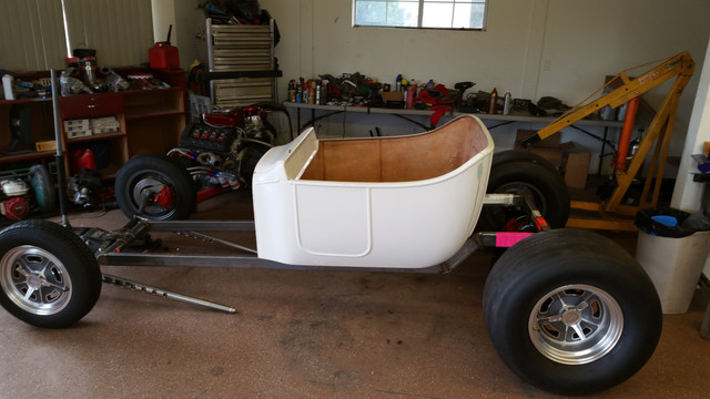

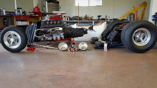

The T in my head, thoughts?
I can see where a frame might just come in pretty handy . . . . :thumbsup:
Like the wheel choice, nice and contemporary to go with the engine choice . .

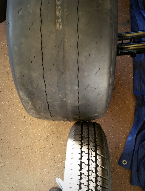

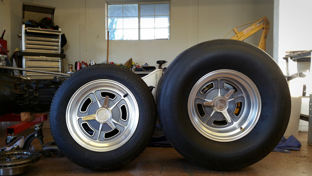

Didn't see it anywhere in the post thus far so would like to ask: Who is the wheel supplier and what are the widths?

What wheelbase are you planning?
Not sure yet. I'm playing it by ear

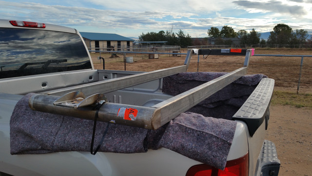

...Is the frame a custom, or one of the usual manufacturers?
Speedway Motors Nostalgia T frame
...Didn't see it anywhere in the post thus far so would like to ask: Who is the wheel supplier and what are the widths?
American Racing VN502, 15"x10" rears & 15"x5" fronts. Rear tires are M&H 30"x14.5" (12" tread) Cheater slicks with tubes. Fronts are Firestone 155/80-15

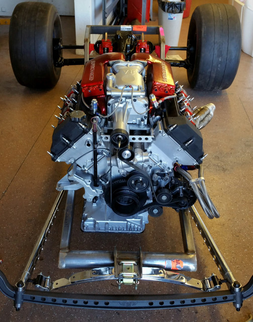

Frame arrived: Speedway Motors Nostalgia bare T frame. I was saving up for a CCR frame, sent an email to the company explaining I'm ready to order a bare frame. They responded that they've had a price increase and the website is out dated with old pricing and they weren't willing to honor their misleading online price guide..... Not only did their new pricing go beyond my budget it also makes their bare frame the most expensive frame on the market. Instead I ordered up the Speedway frame and couldn't be happier at the moment.

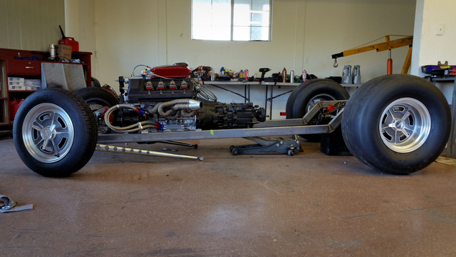

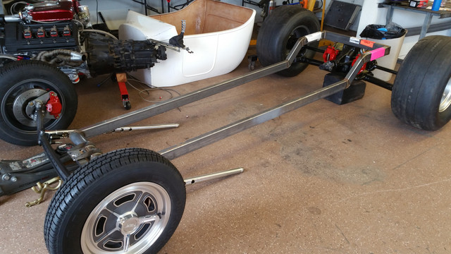

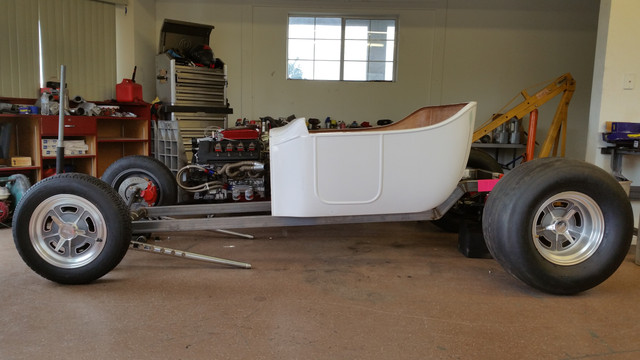

Having the rear most crossmember resting on the Jag diff has what I'd consider a nice & long wheelbase. The front of the frame is a good height but the rear is too high for my taste. I think ultimately the rear end is going to come forward and up into the frame, that will also pull the rear wheels in closer to the body. Unfortunately tucking that diff and brakes out of view
I definitely like the wheels back, (maybe that's why I'm partial to the 27) how about add 6" or so in the frame's kick-up?
I haven't a clue based from experience, as to how narrow-able the Jag rear is, (but it looks like it would be a job from hell to pull off) but if you widen the extended portion of the kickup, you'd have the structure for decent geometry for the spring/shock mounts without having to narrow.
I'm told earlier 55" wide half shafts and lower control arms are interchangeable with those from 61+" sedan unit used buy OP. If those are not available, the sedan half shafts and lower control arms can be narrowed. Here's a picture of mine narrowed to 57".
Narrowing a Jag IRS is not really a big deal. Lathe and welder is about all it takes. plenty of info on doing it if you do a search on Guggle. E Type or early Mk 2 are the narrowest, although where you can get one these days is a different matter.
Most want the rear wheels to just 'cut' the body; if they are too far back they can look as if they are an add one, rather than part of the car. Course, all always JMHO.
As to width, well LST has always been a benchmark for Ts.

Check the wheel base and use softer spring rates to soften the ride. No frog hoppin' over bumps in the road.
A lot of guys over here in the past, used only one of the coil overs on each side, instead of 2. Might give you a starting point to work from.
