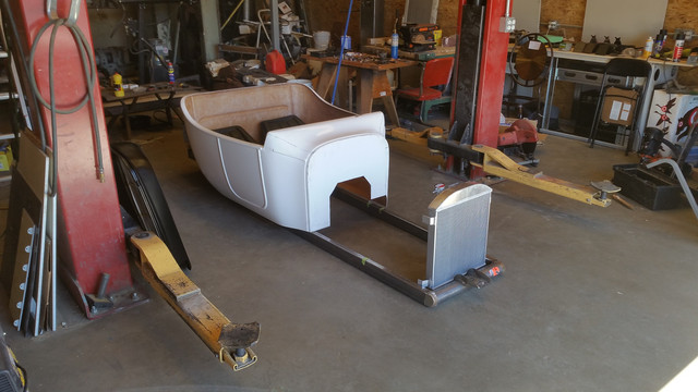

The T in my head, thoughts?
Can you give his name?
His name is Jeff Martin out of Illinois, he lists these tops for sale on various T bucket groups on Facebook. It's a good looking top, the fit and lines work good on my speedway standard '23 body. The top is rough as-is and needs some finish work, I believe Jeff intended it to be bonded to a body so it would need some structural bracing to be a removable isolated piece.

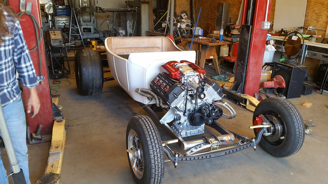

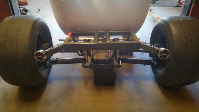

I think it's very clean looking motor , will it work in a T or roadster time will tell keep us informed, I like when someone thinks out of the BOX .

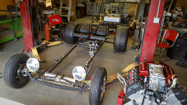

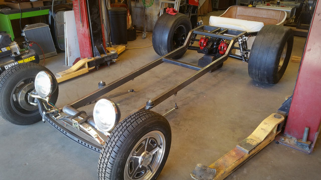

Good to see you are back at it again. It appears that the head lamps are attached to the steering arms. Optical illusion?
Tanks Panky (from Lil Rascals) I remember the Tucker having a 3rd eye. Seems that there was another car that tried that with head lights. I think it is an interesting idea and hope it is sucessfull.

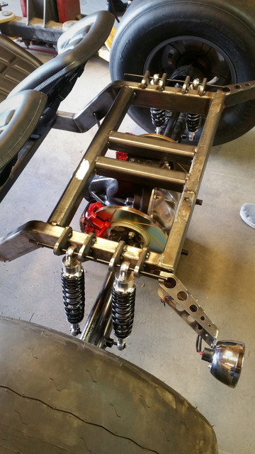

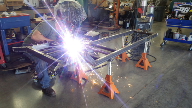

My first time welding. Just tacked things in place until a real welder with some real firepower can finalize everything.

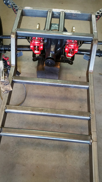

Just a few more things to tack in place before sending the frame off to a pro welder.

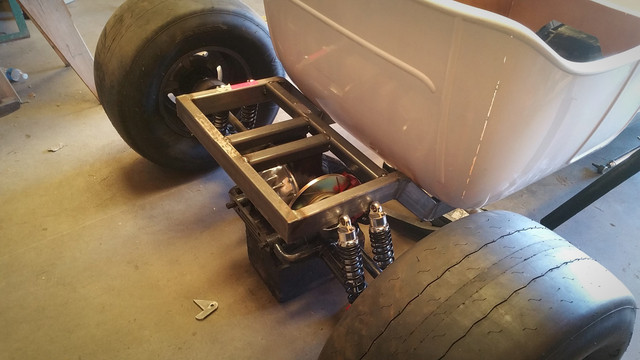

Man, those are some heavy duty coil-over mounts on the frame! They'll never fail.
That's the plan. I debated on mounting them under the frame so they carry the weight rather then lift the weight. But that would've raised rear ride height higher then I wanted.
I love getting everything tacked up to see how it is.
Mock up and fitting / re-fitting. and just getting it right is great when you can just sit back when its done and say ..great I don't have to do that one again.
Nothing worse than having to blow it apart and do it over.
