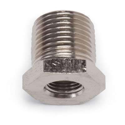

How did you hook up a sensor for your trans gauge? I've been thinking about adding a trans guage but am unsure about how to do the sensor.

I drilled a hole in my sheet metal pan just big enough to clear the threads of the sender. I put a nylon washer on the sender and ran it through the hole, then put on another nylon washer and used a reducer (see pic) as a nut on the inside of the pan. 1000 miles with no leaks.
