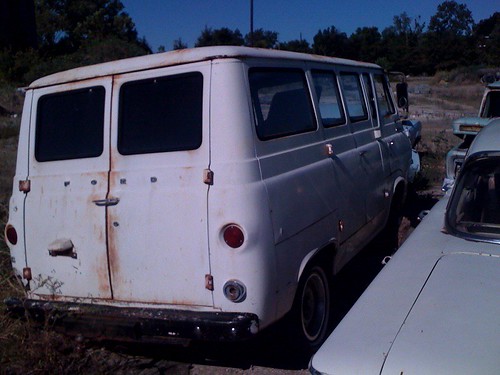

I'll be ripping an axle out of an Econoline tonight.
Pulling the rear, yanking the front, removing the doors and windows and anything else that can be removed, and scrapping it.
Darn shame too, it's 100% there and all it needs is gas and a battery to roll.
Oh well, that's hot roddin' I guess.
