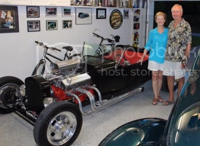

    Keep in mind that the 27 cowl is also longer, and if you mount it as you describe it will extend into the area where the engine is.

    That is exactly what I have on my T. It's registered as a '25 and I say that it is a prototype for the '26 and '27 T's. It also gives me more legroom than the '23 style cowl.
