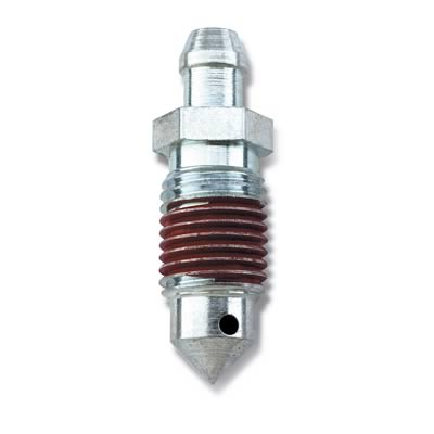

What's a good source for a speed bleeder?
I got mine from Summit. Be sure to get the ones with thread dope on them. Without the dope, air will bleed past the threads when you release the brake pedal. Here's what they look like. They have a spring-loaded ball valve inside that lets fluid out when you press the pedal, but won't let air (or fluid) back in.

You'll need one for each caliper because you leave them in after bleeding, just like regular bleeders.

Lee those speed bleeders might be just the thing will have to get a set. Bleeders that are in cyl. now have very poor heads on them interesting that all 4 were a different size 3/8", 5/16", 10mm and 9mm made for some interesting expressions when I tried to use the right wrench sort of went **(&%$%%^&^##(^(&%&^$*%( or words to that effect
