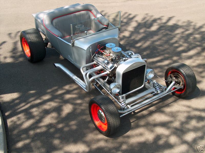

Hello to all and happy new year. I have been thinking about this for a while and really considering it now. I would like to change the color of my bucket to a flat black with retro flames possibly. The color now is a ford silver and would like to just paint the fiberglass parts (bed, body, grill shell) and leave the frame silver etc.
My first question is can this be done by an average person. I have been told flat black is easy to spray, but not sure about prepping. I was told that I could spray over the current paint with little prep (scuffing etc.), but just not sure if I believe that. Obviously, I want to do this right so seeking advice from the paint experts out there. Below is an older pic of my bucket (pre interior change etc.).

Thats a fine looking car you have.WHY change the paint?If anthing i would highlite the edges of the car or flame it.NOT change the car.
it's your buggy but it's way to nice to shoot it flat black, i agree on the flames over the silver, that would look really nice, but then again it's not mine and you have to be happy with it. do what you would choose and good luck. chaz
I think flat black would be a good choice if you were trying to hide a rough finish or dings in the body but your car looks great. I agree with the others, I think flames and either highlighted edges or some pin striping on the silver would really pop.
Thanks for the advice guys. Based on your responses, how hard would it to be to lay some flames down over the silver? Again, what type of prep would be involved (just scuffing or more). I love flames and draw them on everythin...lol. I thought of doing maybe some pin stripe flames (red) or laying out some simple retro style in a solid color, but again, was not sure about prepping the base coat etc. Thanks for the help!
Be sure whatever you put on is compatable with what is there now or you put some sealer on it to keep it from killing itself! I like flat black and flames!

That silver is tits! Dont lose it...just punch it up a little. We're at the end of the flat black craze. The old diehard that did it before it was popular, will continue to do it, but now a lot of people are using base/clear with a flattening agent in the clear to make a flat or semigloss color palette. The old way to do it is put a piece of paper (they sell stick on paper called 'Sticky Mickys') on the car and draw your design on the paper, take the paper off when youre satisfied, and trace the outline of the paper with a pounce wheel, put the paper BACK on and pat the paper with a chalk bag...it will leave an outline of chalk on the car. Take the paper off, flip[ it over and tape it on the other side of the car, chalkbag it. Sketch in any missing parts on the car with a stabilo (water soluable) pencil. this is of course after you scuff the car and wipe it with wax and grease remover.
me, I like dark sort of metallic 'burple' (blue-ish purple) on silver. I saw a silver chevelle with a hand done pinstripe in that color...tits
I also dont like flames that look like crab claws...I like longer, thinner flame licks.

I agree with that. Satin black is played out. Actually it was as soon as it got popular. If you like the color, then definately do it. But if you are just wanting to do it because it is popular. Don't.

With the silver base, candy flames would be an easy choice. Silver makes an excellent base for candies, and modern urethane candies are easy to spray and do fades with. It should be as simple as masking off the flame design, scuffing the area with a fine scoth brite, spraying an intermediate clear (like clear base coat) for the sealer. Then the flame color. Then clear over that. and unmask. Get a pro pinstripper to stripe next to the edge. That will finish off the flames, and kill the paint edge. And it won't require disassembling the whole car.
Leave it silver and add the real fire flames. Your car has a modern flavor to it, don't give it old school flames.

Imho, Your ride looks great and I would leave it alone. Or just do some small stuff like adding some ghost flames, or pin stripes.

It's your ride and you need to do what you need to do, but if I'm seeing it right you have just orenge and silver. It is absolutly neeto the way it is, I'll trade you an empty Spirit body strait across and throw in some junk, LOL, but if I wanted to spurce it up for the sake of change, I'd find a pinstriper and lay wheel orenge pinstripe flames and dutch the tailgate.
