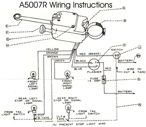

Using the 5007R turn signal switch. It has 7 wires. It also shows a 3 prong flasher, but mine is a 2 prong flasher. I read somewhere on line to connect the #7 and #6 wires together and then to the turn signal flasher. Turn signals, brake lights all work correctly, but when switch is centered, flasher keeps clicking and the red hazard light on switch flashes. I'm thinking one of those wires needs to be connected to the brown hazard light wire from the harness.
Don't know for sure.
Is this the correct wires and colors?

Okay, here is what is going on. Hazard lights will not work with key off. They should work without key on. Turn key on, flasher constantly clicks and hazard light on turn signal switch blinks with flasher click. Signal lights work correctly, and all four lights flash when hazard button is pulled out. So, the problem is in the hazard lights wiring. Right?
I think you should call Rebel. Their fuse block has two flashers, one is for turns and one is for hazard. But how their harness connects to the switch is a mystery. And the switch could be bad.
Do you have the Rebel harness instructions? Is there a wiring diagram? I'd like to see it.

Well, I just clipped the blue wire. Signals work, flasher is not clicking all the time, hazard lights don't work. Never use em anyway! Works for me.
