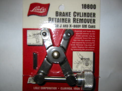

Here is a pic of that wonderful tool. We had one when I worked for Chevy dealer and one other person had one.
