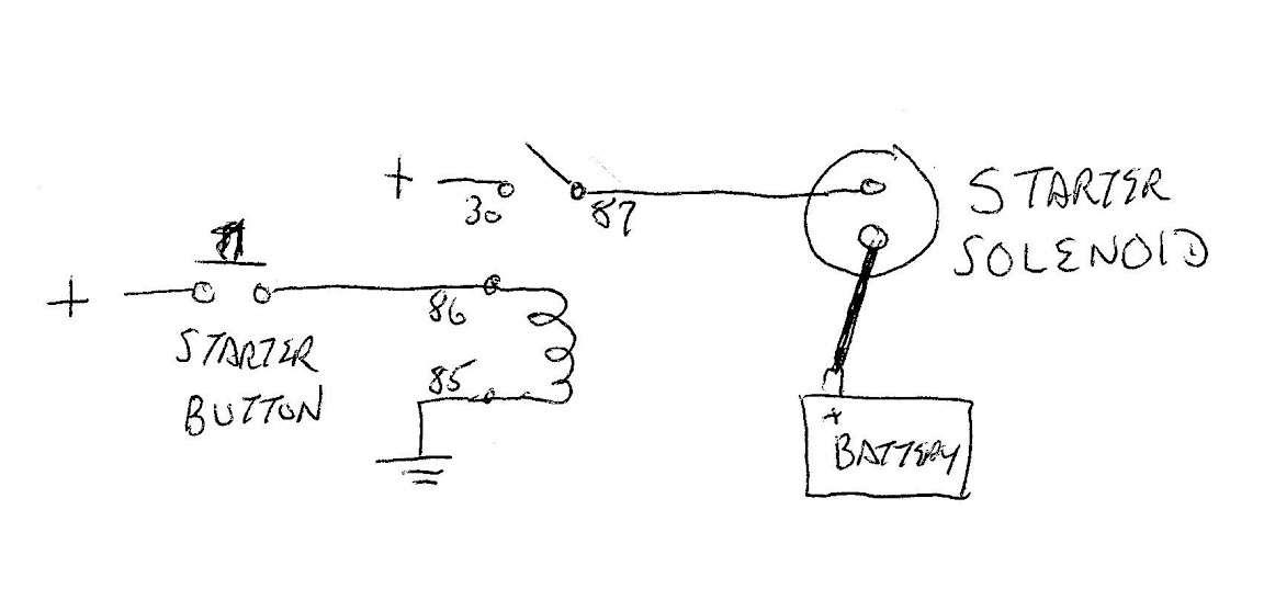

I also use a relay in the starter circuit; the starter button on the dash controls the relay, which in turn controls the starter solenoid. Also relays for my electric water pump and my electric fuel pump.

How do you wire a relay for the starter?
How can I use a relay for my acc toggle switch?

Like this:
For your accessory switch, substitute it for the starter button in the diagram, and put the load (light, pump, etc) where the starter solenoid is shown.

On the diagram where you have the + going in. Is that straight from the battery or switched acc. from the fuse panel?
Depends. I'm gonna guess you are using a wiring kit and an ignition keyswitch, not a separate starter button like I do, in which case the control to the relay would come from the ignition switch "start" connection, or the starter wire from the fuse panel (I've never used a wiring kit). The power to terminal 30 of the relay could come straight from the battery or from fuse panel switched or any hot wire.

I'm running a push button to start the car.
Ran all my own wire. The switch is the acc. or on switch to the fuse block.

Speedway has that 70amp relay. I'll go get one tomorrow
I'm guessing that would go before the toggle switch.
30 would be + from the Battery,
85 Ground, 86 and 87?

Can I use a 40amp relay before that or use a 70amp there too?

Just like the diagram, but put the switch where the button is, and 87 goes to the fuse panel.
The headlight switch is probably OK by itself (it's designed for the load), but a 30 or 40 amp relay could be used there too, and that is just a $5 relay.
That's it. And I would replace that switch. The fact that the LED burned out makes me suspect the switch got hot and could be messed up.
