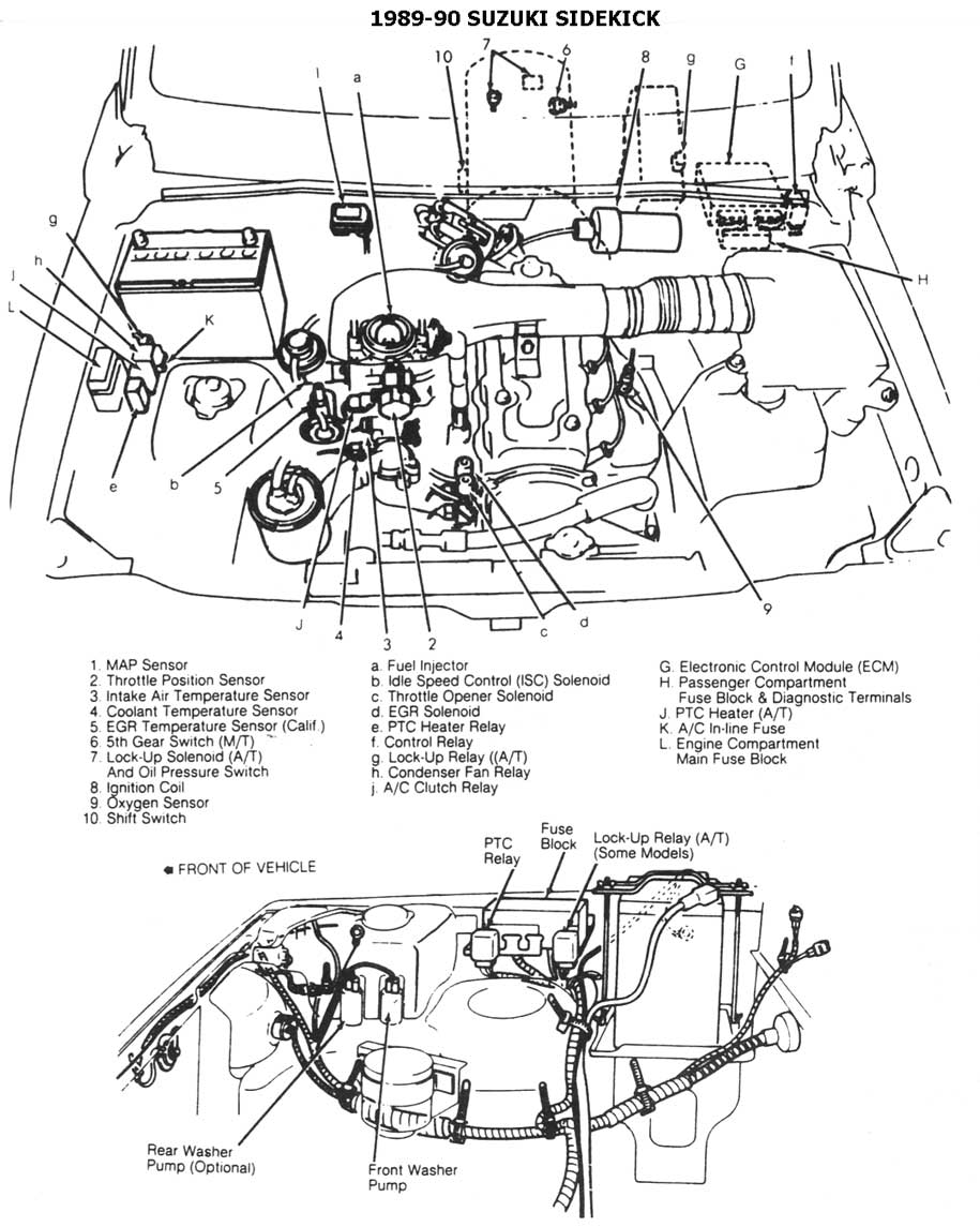

Hi guys i am mike & i have a 89 sidekick i bought from someone that was doing a frame off resto, i found the Distributor and has 2 wires one looks brown or a light orange the other is black , i would like to connect straight to my coil , but i don't know witch wire go to the coil & if it is positive or negative , can i get some help with the please ? thanks guys
