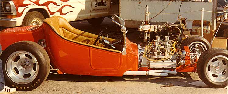

That flat 4 makes for an interesting look. Really cool.
I wonder what that is on the front of the engine. An oil pump? What do you suppose was used for a transmission in this T and how they adapted it to the VW? Since i like both Ts and VWs I wouldn't mind building something like this.
This particular corvair appears to be the six cylinder version.
There are LOTS of adaptors to mate almost any engine to almost any transmission.
I'll try to find the pics of the front engined VW T Bucket. Might take a while.
That's a pretty interesting front axle design too.
You're right. I should have looked closer.

It looks like a remote oil filter and the alternator on the front. the stock corvair had a fan mounted on the top of the engine. the belts made a 90 degree turn to run the fan. I had a friend that had 3 corvairs, the one i liked the best had a paxton blower on it. It had the remote oil filter. Big Jim, the corvair man set it up. He cut off and machined the oil filter casting and added remote mounts like the T has.. the paxton was a 2 speed unit. lots of low end boost then at higher speed the planetary ball drive slowed down the blower so it wouldn't over boost. I took it out for a test drive after I had been working on it and at a stoplight a guy in a GTO was eye balling the 10 inch wide tires on the back. The "vair pulled away from him...the engines are very sensitive to overheating. all the pushrod tubes will leak if you burn the o rings. if the air flaps on the back don't work right they toast in a hurry. You used to see a few with an oil film on the back end .. like some old
