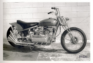

Speaking of Corvair engines and T-Buckets, we can't forget Norm put a Corvair engine in an Indian cycle called the "Six Pack"

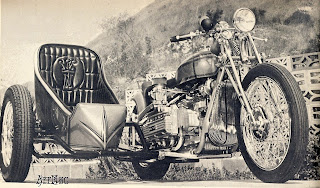

Maybe Ted can touch on this one but in 1968 A.E.E. Choppers in california made a wild looking Trike with a corvair motor.I got the build book(sorry gone now)from them and they said to Flip the automatic trans over and it would go in the right direction.My memory does not tell me what else had to be done but it was the most awesome trike ive ever seen.Come on Ted dig deep and find some pics.

AEE Choppers Corvair Trike had a flopped third member not trans. I cant remember what rear end was used but that how they did it. I worked there and was around that trike a lot and even got a ride in it a couple times. It was solid as can be and would wheelie on demand pretty much. Big wheelie bars out back.
It was on Ebay a few years ago and supposedly someone in LA bought it to resotre. I saw pictures and it was still in the original paint but the seats ahd been changed out at some point.
Any pics of it?That was the baddest thing i ever saw and swore id make it one day.Guess i shouldnt have sworn
I just won an auction on Ebay for a 1968 issue of cycle guide with the trike on the cover. Here is a link to a picture of the cover:
Cycle Guide Magzine July 1968 Special Custom Issue - eBay (item 290292973814 end time Feb-02-09 17:55:00 PST)
At the time it was the only trike running around with the engine in the front, all the rest were VW in the rear like Roth used to build.
It was so cool, every day I got to see it for a couple years sitting in our showroom. then again we also had a twin engine sportster trike...well actually it had 5 wheels! I in front and 4 out back.
Man does that bring back memories.I had the build book they sold so anyone could build it.On the cover of the book it had that chick and if i remember right a cougar or some other big cat.Is there an article on the trike in the book?
