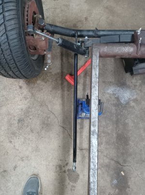

I just picked up a front tube axle setup. It has the radius rod brackets welded on. It looks like the brackets have been welded 90 degrees to the axle. This means the radius rods won't mount to the frame (see picture). I could make some sort of bracket that sticks out from the frame for the mount, or I could cut the brackets off and re-weld at a slight angle. Which would be better?20251129_234542.jpg
Keep in mind that this will also affect the spring shackle location. Might be easier to just heat and bend the mounting tab on the R?R bracket.

Easiest is to bend the radius rod somewhere behind the clevis and let the heim joint at the back take up the slack. You might have to space the heim joint off the frame rail just slightly. I had one that was bent that way from a curb and I never bothered to fix it. Didn't cause any problems.

I would prefer to bend something to correct that gap, rather than hang to rear joint 3 inches out from the frame.

Make saw cuts about 3/4" in above the lower clevis mount and below the upper clevis mount, heat & tweak the clevis mount to the correct angle to bring the ends of the hairpins to the side of the frame rails, and once happy with the angles, weld up and blend in the saw cuts. Probably could just bend the ears with a 24" crescent and forgo the heat.
I ended up putting it in the mill and milling a small slot down the bracket. I then put it in the vise and I could bend it slightly in. When I get everything aligned just how I want it I'll put a few weld beads in that slot. Seemed to work.
