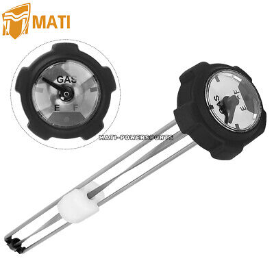

Another option, if you don’t want to cut/drill the top of your tank, is a gas cap with the float and gauge built in. You won’t be about to see your fuel level without looking over your shoulder but you would not need to make any modifications. The caps come in different lengths. You would need to make sure it fit your tank, otherwise it is screw on and go.
Where do I find something like that? or what is it called so I can hunt it down?
Thanks, I'll give it a shot :)
Here's one possibility . . .
So, in researching that part, I found out it's a screw on cap and not a twist on. I'm trying to find a twist on cap instead. Let me know if you happen to come across one, that'd be awesome.
