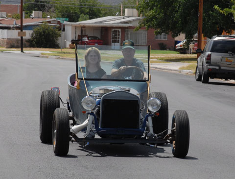

ok I'm going to try this.BH if you can see them, thees are the stands I made for John's car. they are made from four pieces of 1/8" steal and I am not as good a fabricator as most on here. they curve up from the frame and mount the shocks and lights.
hard to see but the only pic I have online :rolleyes:

Great detail shots Bill. Those stands look like they serve 3 purposes.
My headlight stands are steel, and welded directly to the frame. My bucket is going to more truck then car so I wanted something that looked beefy, fact is you can stand on them and they dont move. They look crooked in this photo, but not on the car.

I'll have to pull her out of the garage to get a pic of the base. They're bolted in with riv-nuts nice and tight with no wiggle.
Here is a pic from the front though.
