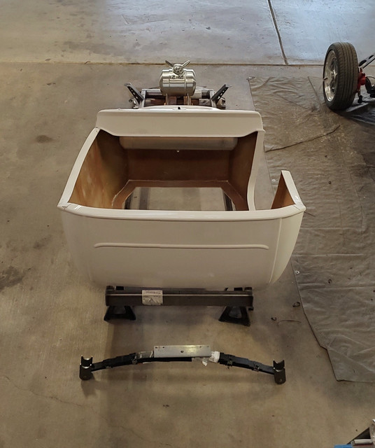

The rear leaf spring idea may not pan out in the long run, but I'm going to try it. Here you can see the wrong spring is bolted to the wrong plate thickness at the bottom of the Jag diff. I plan to make a .250" thick plate that bolts to the bottom of the diff and is welded to the front support mount bar not yet installed on the jag rear end. Then run the front diff supports from the cross bar up to the frame.
The new body arrived last night:

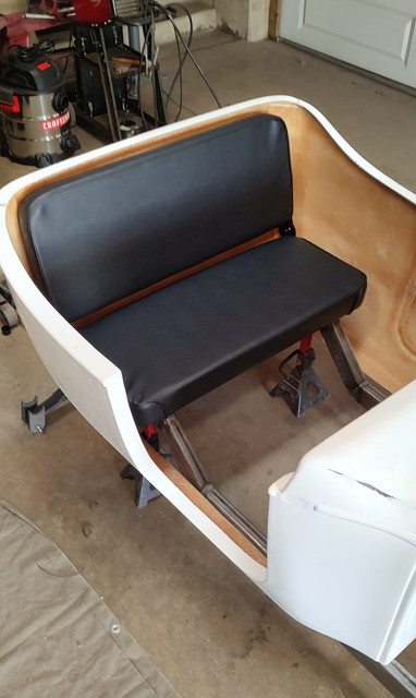

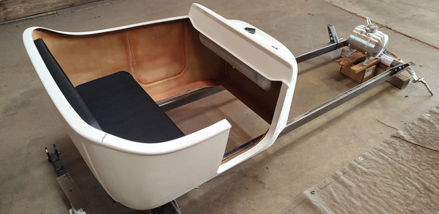

Planning to keep the kick up of the frame in the body. Mount the bench seat to the kick up, mount the electronics under the bench seat.

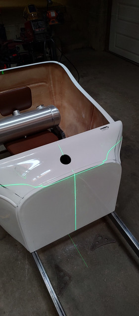

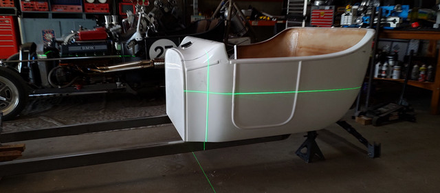

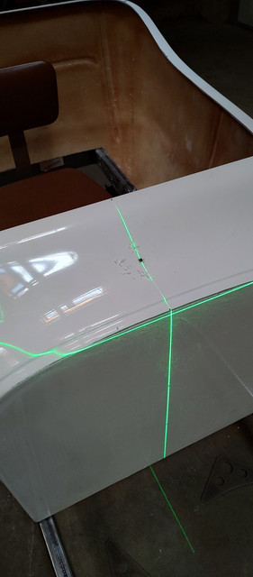

Cut the window out of the body for the frame crossmember to sneak through:
Marked the laser lines on the body above and below the frame rails and cut it out:

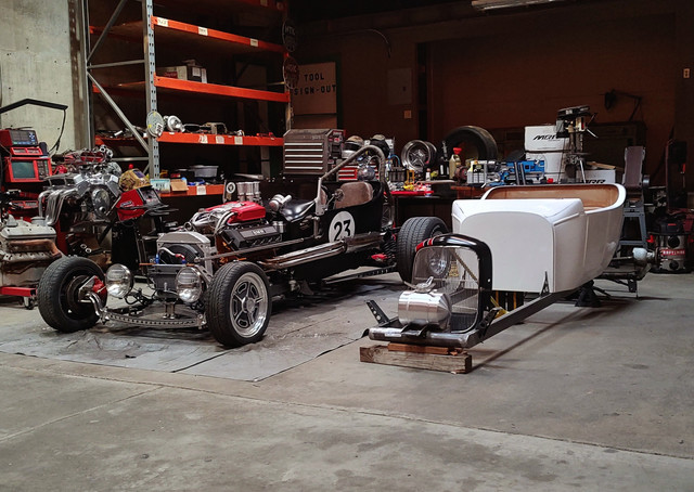

My question is: will you wind up with two T-buckets or just one with a "donor vehicle" in the back of the shop?
... will you wind up with two T-buckets or just one with a "donor vehicle" in the back of the shop?
The current plan is to use the drivetrain, front axle, steering and some suspension bits on the new bucket. Simply because I can't afford to build, register and insure an entirely separate vehicle and have two on the road at the same time. I still plan to take the new frame and body to my Az MVD with the MSO certificates for inspection and VIN assignment.

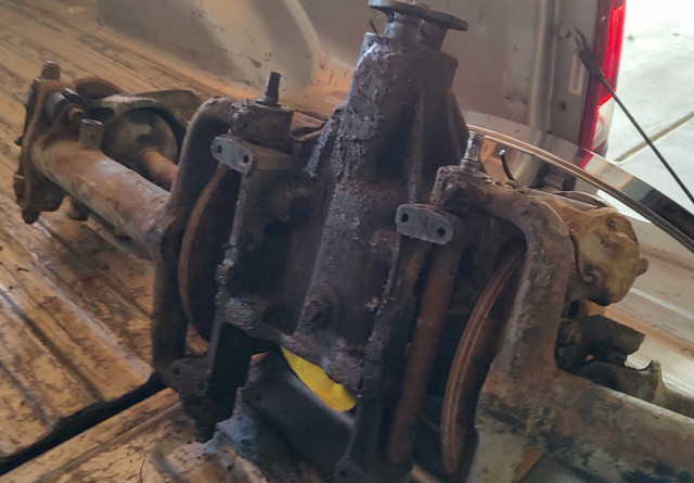

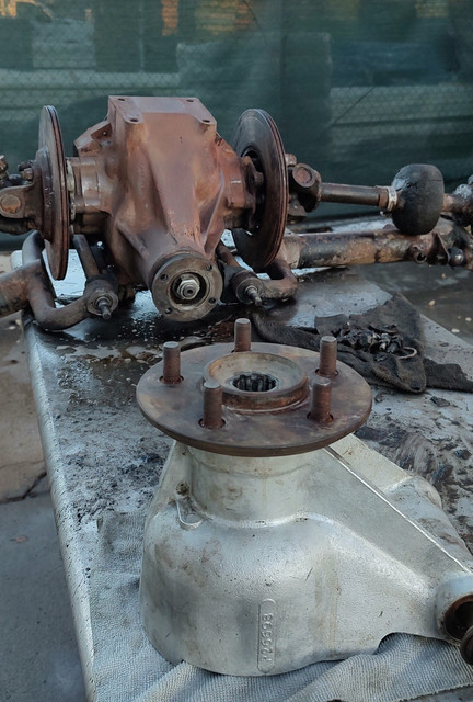

Once the rear diff perch arrives I feel I can hit the ground running with progress... admittedly I am procrastinating the days worth of labor cleaning, degreasing, descaling, rust removal and painting of that Jag rear end.
The cheapo pendulum style laser level is working out better then I thought it would for alignment of components, jokingly giving this project the working title of "Laser Precision" however the name won't match the character and style of the car once it's further along in progress.

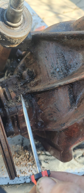

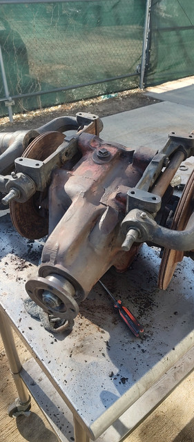

Working on this for two days straight thus far, roughly 80% completed. Dismantling & degreasing the Jag rear end.
Foamy Engine Brite, Aircraft stripper & Brakleen cocktail, wire brushes and using a screw driver as a chisel.
New brake rotors, Calipers & pads on order. This differential has the caliper mount plate that bolts to the stub axle flanges, as opposed to the caliper mount bosses cast into the diff housing. It might be cool to find a way to flip the calipers around and have them rear facing.

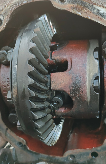

This diff has 3.51 gears and I believe this is the Dana 44 Power Lock LSD carrier:

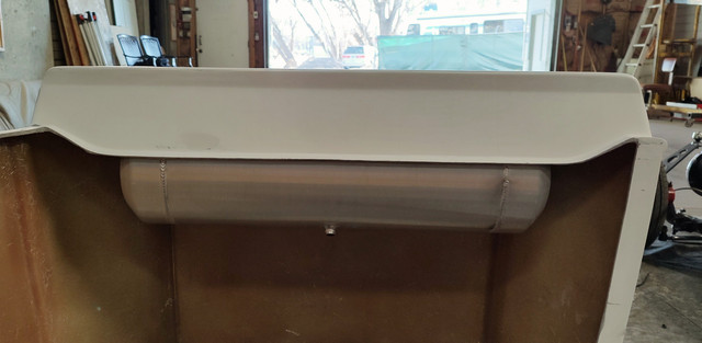

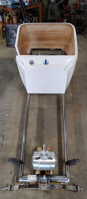

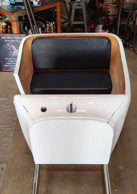

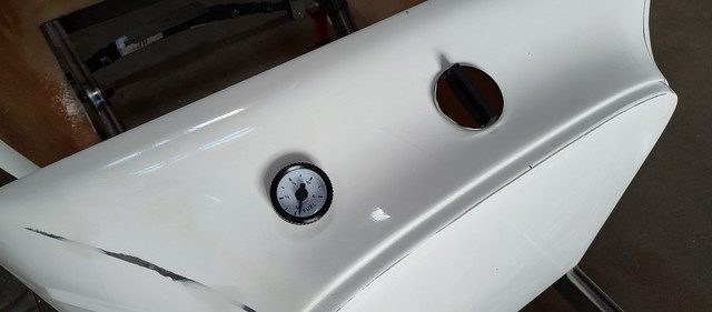

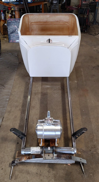

The idea for the main fuel tank. 8" x 28" aluminum tank under the cowl with the filler through the center. I'm sure a more talented fabricator then I could of come up with a snug fit tank to utilize the space more efficiently.
It won't leave any room for gauges or switches, but I have an idea for those.
I was dreaming of a big flip up Cobra style filler cap, but the cowl shape doesn't lend itself it to that style of cap. So instead I'm thinking a smaller Monza style flip cap. The tank will be supported by the arms used for the steering gear for the cowl steering, however the box will be mounted lower then it currently is in the other Bucket.
The tank hanging down below the dash does look like a space hog, but there is still plenty of foot, pedal, steering gear and bellhousing room.

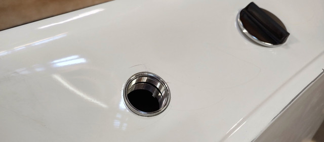

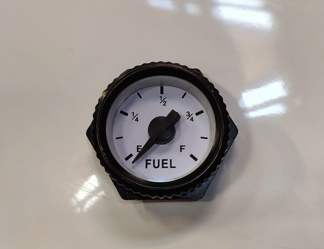

I was going back and forth on this one, I eventually talked myself into it...and I'm regretting it. Mounting the mechanical fuel level gauge on top of the tank through the cowl.
Pro's:
•Simple
•Already have the parts
•Works
•No extra parts, technology or wiring involved
•Watch the fuel level on the gauge while filling at the pump
Neutral:
• Checking fuel level while getting in and out of the car instead from the drivers seat
Cons:
•I don't like the look of it
At first I though I could make the gauge itself less bulky and perhaps smooth it in by chucking it up in the lathe and removing the large hex from the gauge housing. Then recess the gauge lower in the mounting on reassembly.
And that was better...but still not happy with the outcome.
I convinced myself it'll look better and blend in once the build gets painted. Ultimately I think I'm going to teach myself how to patch fiberglass.
Did you cut the hole with a hole saw and save the cut-out?
Are you going to use both tanks? How will you vent the front one? Did you build the seat? What is the wheelbase? It looks longer and I like long!
I'm planning to use the front tank for the water for the supercharger cooling, looking like a 2 gal moon tank up front.
Purchased the seat, I don't think one could purchase the materials to build one for the price of ordering one. Texture and design would look nice, but I like the simplicity.
It is going to be a long wheelbase, longer then my current Bucket. Even with the front spring over the axle instead of behind. I don't know exact wheelbase yet, I'll have a better idea once the rear differential perch is in place.
