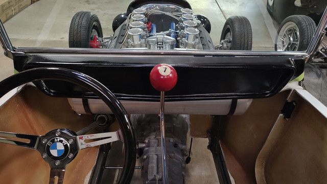

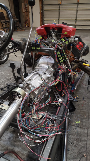

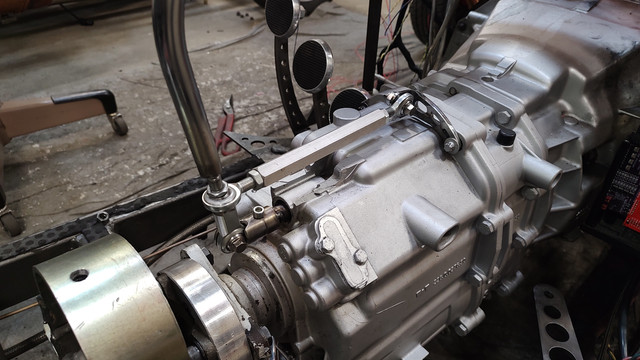

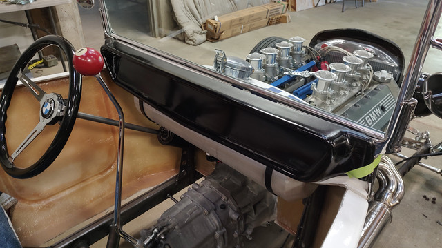

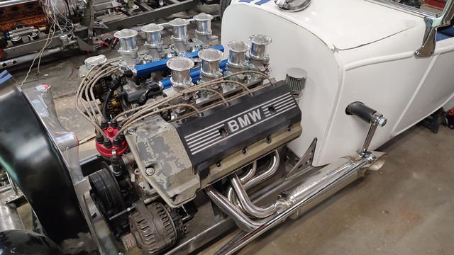

In the spirit of cleaning things up. Relocated the heim turnbuckle pivot for the shifter, made a new hemi anchor bracket.
Moving the pivot point lower sure does make getting into gear way easier, at the expense of more exaggerated movement at the shift knob to get there.
Once the body is back on we'll see if the increased throw has me punching through the plexi windshield to get into third gear.
