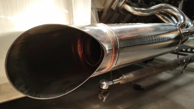

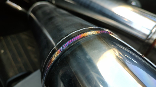

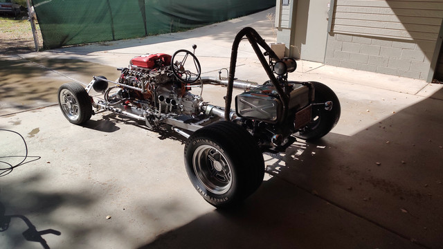

Got the exhaust turnouts-mufflers & mufflers-headers TIG'd on:

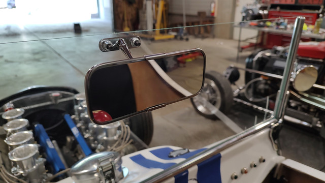

The CCR windshield posts and frame arrived, got that mounted this morn:
The plexiglass is a placeholder for now, the plan is to use a glass windshield with a 60's vintage green tint.
Have you been in a T-bucket with a tinted windshield? I find the reflections to be distracting, but . . . to each his own! Your build is looking killer!

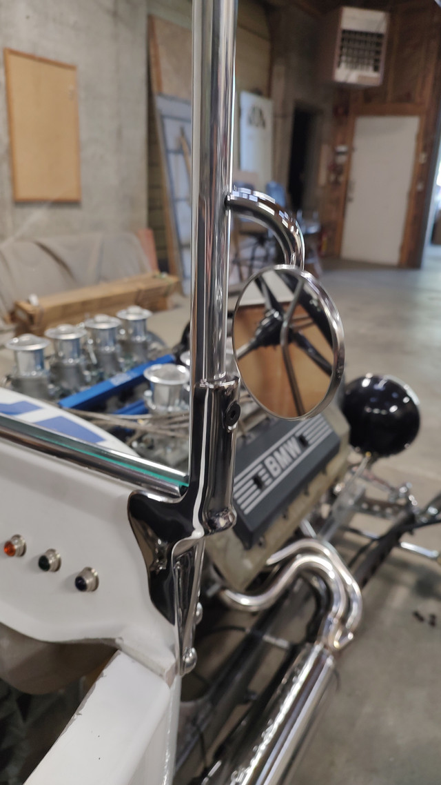

A benefit to the plexiglass, or in this case acrylic, I can drill my own holes for the mirrors:
The 3" peep mirrors on the uprights look good, but far from practical.
Unless you plan to have a top, the peep mirrors should be adequate, IMHO. That's what I use with no problems. Of course I could say, I don't need no stinkin' mirrors because I'm leaving everyone behind! (LOL)

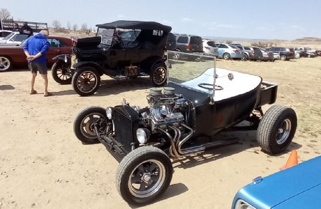

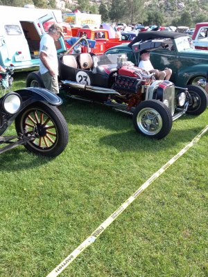

Hello Myyk!
I've been following along on this avidly. I saw you Version 1 last year at Watson Lake but didn't meet you. I had just got mine and hoped to talk. Then found your youtube and your posts here. Love the effort you put into each detail.
A photo similar to that one was on the cover of the Courier last Friday, promoting this years Watson Lake show. I was unfortunately out of town for the car show this year. Thanks for posting that pic. I'm sure we'd likely still be in that exact spot talking Tbuckets a year later.

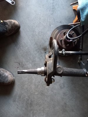

I found a great deal on a couple sets of Willwood D52 calipers. However my brackets are for the small 'metric' gm caliper. I was having trouble finding the correct bracket for the 28-48 spindles and D52 calipers with the offset to match this bearing adapter. Also the cast caliper brackets look way better than the cut plate brackets. So I opt'd to modify my existing brackets:

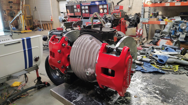

Getting the Wilwood D52's to work on the rear will be quite the feat. I'm thinking of separating the caliper halves and removing 22mm of material from one half and bolting back together. I'll also need to cut pockets out of the polished diff cover and TIG them back together from the inside of the cover. I think the outcome will be worth it if I can pull it off.
Is there Brembo or Ferarri caliper that allows pads to be swapped without caliper removal? I seem to remember this being a thing in endurance racing.
It still requires careful inspection during servicing of course, but could avoid more bolt threading in the 3rd member and would provide a more 'mechanical' and 'light' look.
EDIT: I didn't mean to second guess you and they do match the fronts. Just offering an alternative!
Put mine on the inside. Disk are racing version used on E Types and much thicker than standard ones.
