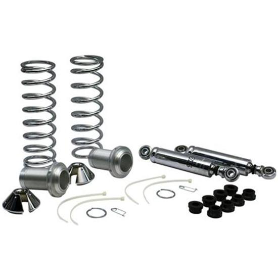

I am looking at ordering my rear coilovers but ran into a question. I made a mockup bar and mounted it to the shock mounts. I would like to keep the ride height like it is mocked up. The question is when measuring for shock lengths, do I take the measurement of the center of the bolts on the mockup bar as my install height when ordering and if so what spring rate? I see information about install height, extended height and collapsed height. I'm lost? I plan on ordering from Speedway so if anyone has suggestions and heck if you know the part numbers I'll owe you.;)
Take a look at these. I think these will work for you. Speedway.
CARRERA COIL-OVER REAR SHOCK KIT, 200 SPRING RATE
Item #: 2553362D
Price: $369.99 KT
Item Details:
14.9" Mounted Length
