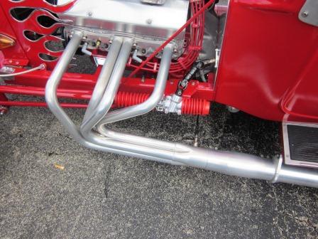

This is how I'm planning on doing mine, which is pretty much how George posted. Mind you, this is not my T, but just a pic I've had saved for a while in my T file.
