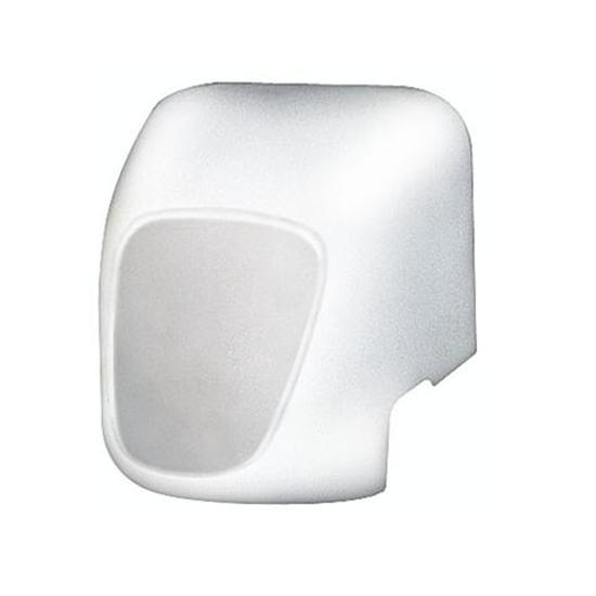

Nose: This one from Speedway Motors with the aluminum grille they sell
Anyone know what radiator fits under this thing?

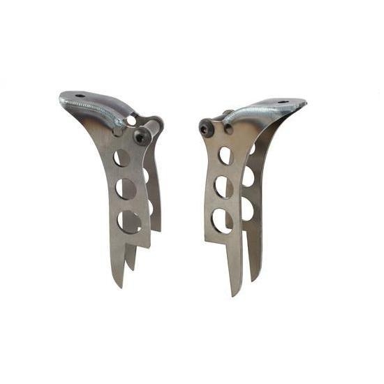

I like these shock mounts from Speedway:

I agree with that, if you are building your own frame you need to make sure everything will fit. Call speedway and they can tell you what radiator and support will fit the track t nose. If you are planing on a hood be sure it will fit if you plan on mixing manufacturers parts ( you could make your own hood). You are on track by making a plan so you can change your mind before you spend a lot of money. I speak from experience.
In my opinion, there are better track noses out there. My Dad's '27 had that nose when he bought his and I didn't care for it then or now. The more oval opening ones are more pleasing to my eye and more traditional. As for cooling these noses, you're probably in for a custom made rad. My dad had a hell of a time cooling his with that nose even with a 4 core rad...he eventually ditched the nose and we reconfigured the front end and used a chopped '32 grille and a custom rad. Cools awesome now.

My personal preference for the nose would be the Speedway track rodder nose and grill if I where following Varner's lead. You need to remember your nose will be in front of the front xmember by quit a ways but your radiator will sit just aft of the xmember. You should be able to run a Mustang radiator with this nose also.

'67 Mustang radiator should fit easily in that nose.

I have a grille shell which appears to be from an old midget racer which has been widened to fit a V8 radiator. I would use the much better-looking Curtiss style shell and widen it to fit a full-size radiator (mine is a Walker). I don't use a grille, just edge trim around the opening. The tongue is optional.
Honestly, of the 3 noses that Speedway sells, I like the Curtiss style least. Taking nothing away from the old Curtiss roadsters, they were great racers! I just aesthetically like the Track T Rodder and Sprint style noses better.
