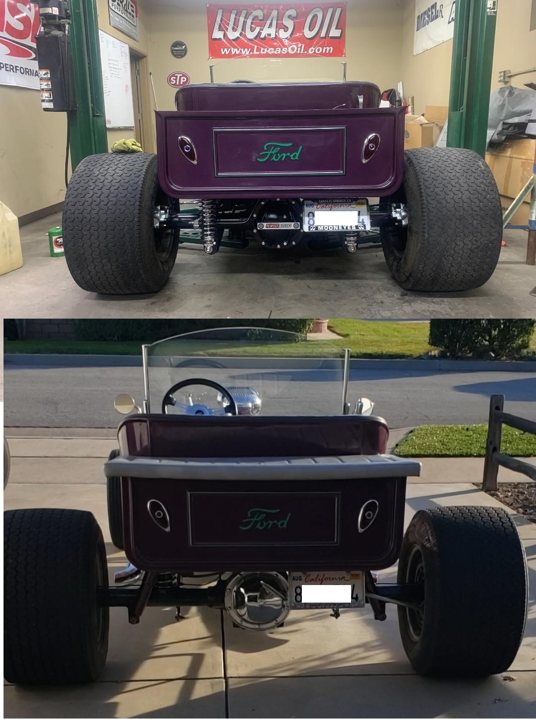

The Explorer's right side is also the perfect length (with the pinion centered) for my current 15.5X29's and wheel offset that will put the tire about an inch from the bed, VS the massive (IMO) 6" gap that I currently have with the 10 bolt (2.43 gear) Camaro unit that's in it today.

Looks, rides and runs WAY better than the 10 bolt 2.43 on legger on coil springs that came out of it! Thanks to RPM for the shocks and mounts and to Jerry at California Custom Roadsters for the ladder bars and advice! Glad to support the sponsors here!!

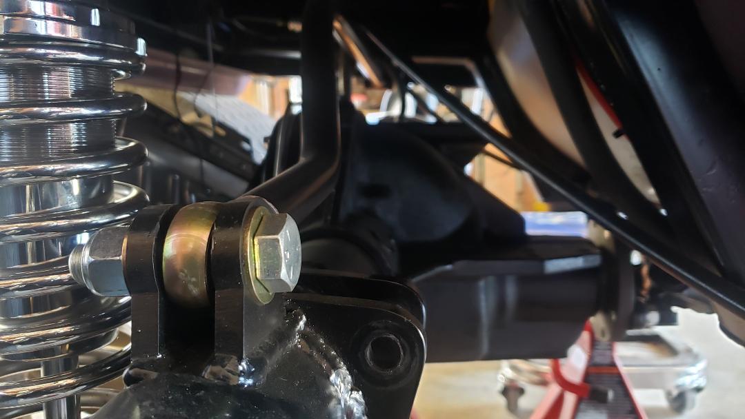

Another part worth mentioning in this rear end swap is California Custom Roadsters "bent" panhard bar that sits down nice and tight to the axle tube without having to use the usual tall bracket to get the bar parallel to the tube. It's a huge improvement over the one that was on the car previously.
Just pulled the radius arms off last night to send to the chrome shop, giving me a "photo op" on the panhard bar. It's a great part!
PS: Doubled up these brackets just like we did the radius arm brackets. "Doubling up" all of the brackets and using heim joints only cost about $60 bucks more than using single brackets with a clevis. I'll never have to worry about bending any of this stuff again!
