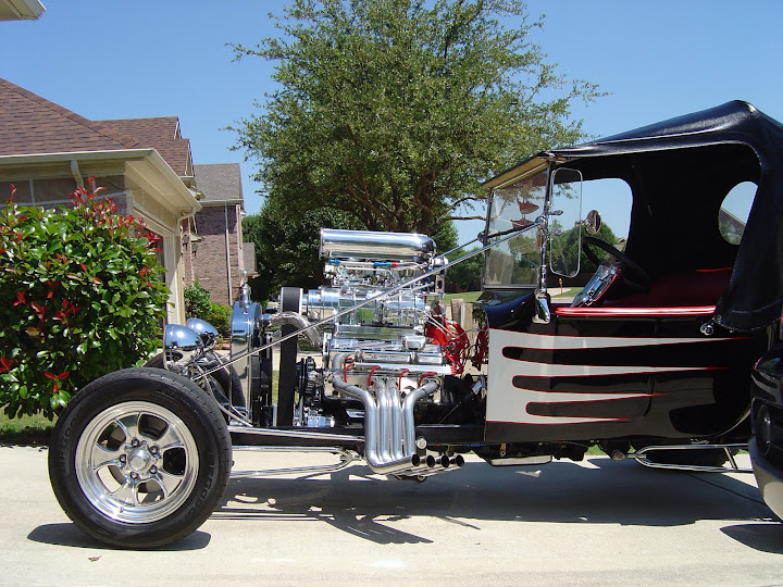

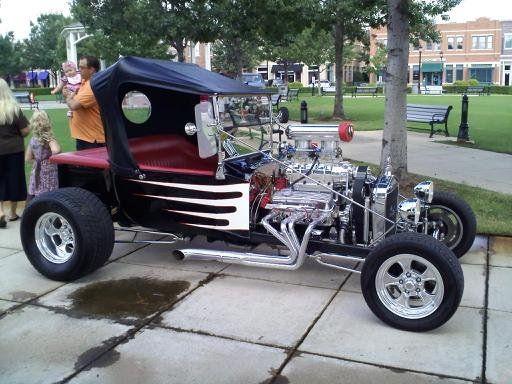

I had the Sanderson 16" Zoomies on my T for about a month. Sounded like a Harley on steroids. With a Top they are loud and got on my nerves. I took them off and went with Sprint style headers with the short turnout.
With the Zoomies
Without
With the Zoomies
Without
Yeah, I've heard your T with those zoomies! SWEET! Do you have any kind of support for those short turnouts?
No supports, with the short turnouts, and when I had the longer turnouts I did use supports either. I haven't had any issues so far.
With the Zoomies
