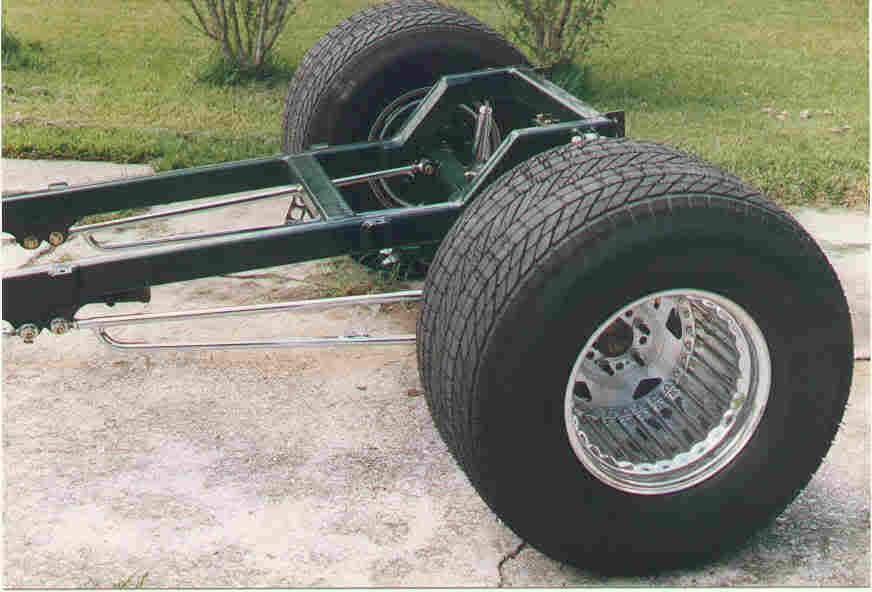

I used some scrap 2"x3" tubing and cut two pieces about 3" long. Cut those on a diagonal and got four trianglar shaped brackets that I welded to the sides of the frame for body mounts. Then used four 1/2" thick carriage bolts and big washers on top of the floor.
http://i940.photobucket.com/albums/ad249/blownt/chasis20.jpg
http://i940.photobucket.com/albums/ad249/blownt/Chasis16.jpg

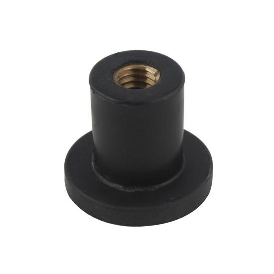

Speedway has these expandable body mounting nuts which look like what you're talking about, although I personally wouldn't trust my body mounting to them. I still like a through bolt to a gusseted frame tab.
You can find them here: BODY MOUNT
The rubber body mounts are what I call well nuts and are usually available at Ace Hardware or Homely Depot, etc.
I wish I had a body to mount but when I get around to having one, I'll probably use these well nuts. To increase the amount of the contact area of the mount to the frame, I would weld short pieces of steel tubing into the frame into which I woulld insert the well nuts. The tubing should be close to the same diameter as the diameter of the well nut shank, but maybe 25% shorter than the length of the shank to allow for expansion when a bolt is tightened into it. Did I say that right?
I make things more complicated as seems to be my nature. I would make the steel tubes 10% longer than the shank and machine a tapered counterbore in one end. I'd then weld a disc over that end of the tube and then weld the tubes into the frame. This is now a closed tube. The tapered counter bore accomodates expansion of the well nut and if I do get water in that area, it would not settle in the frame rails. Yes Paris, the water will collect in the tubes, so I'll fill them with silicone caulk to prevent water accumulation.
Yup, I make my stuff complicated so no one thinks I bought it at J.C. Whitney.
Never cared too much for "Well Nuts)nor do I trust them much.
Too many times I've heard of them pulling out under stress.
