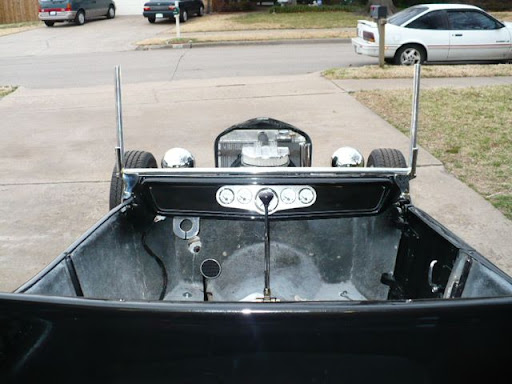

409 r u saying leave it alone ? I sat in it and it seemed ok but i was setting on a board. I can make a new pedal easy enough and make the ofset the other way . And yes the body is the same as yours
I don't know how much these pictures will help. They are taken through the steering wheel, from as far away as my arm would reach. Nevertheless, my left shoe is touching the steering column, and when I step on the brake the inside edge of my right one only misses the column by about 1/4 inch. That is if I step squarely on the brake pedal. I believe that if you move the pedal to the left, your toes will hit on the underside of the steering column when you step on the brake. However, mounting and unmounting a pedal is no big deal. I just thought you should be careful if you were considering bending the brake arm.
Jeff
that looks like what i got. i will evaluate after the interior is in and report back. Thanks for the pics
