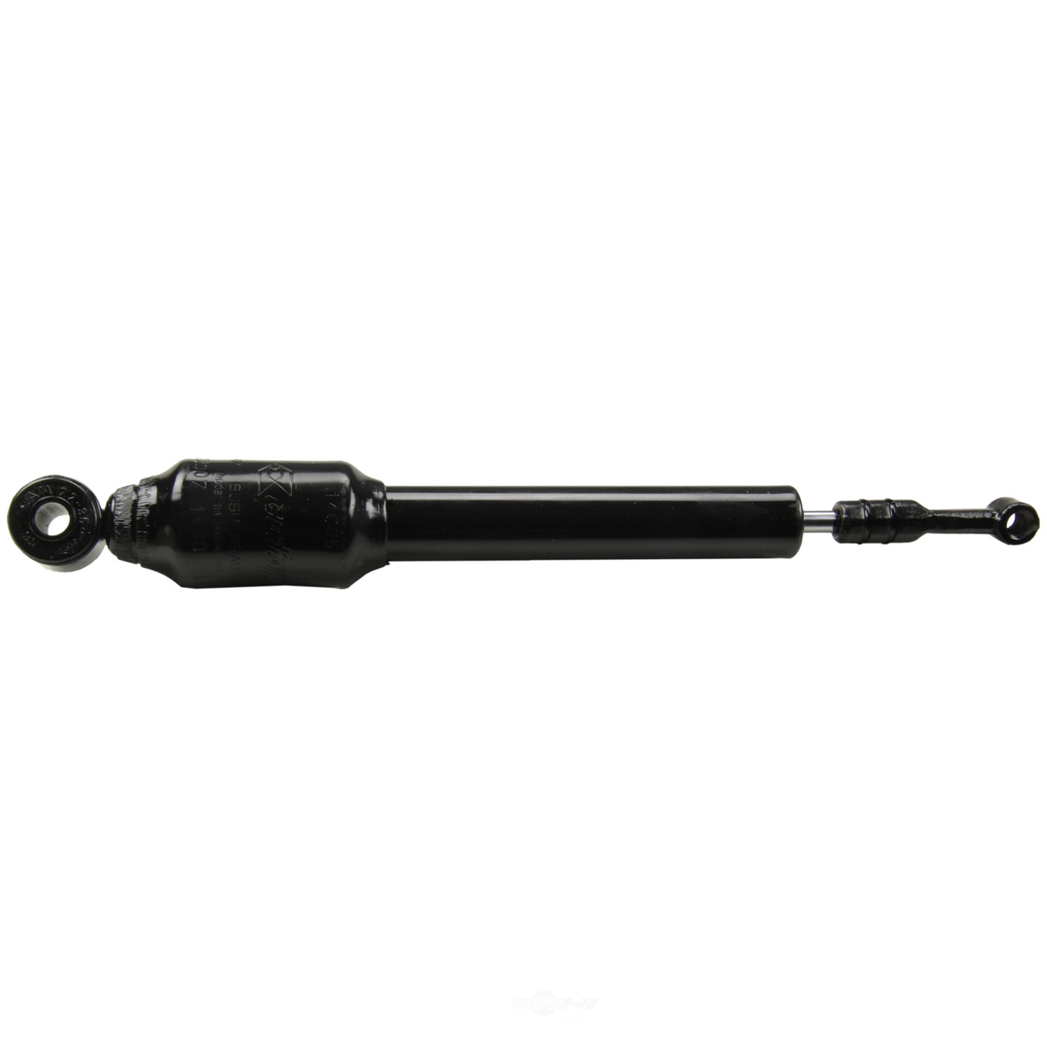

At speeds under 5 mph, when the front wheels hit a stepped series of bumps with no steering or braking input, they would oscillate from side to side (aka death wobble).
I went through all the steering hardware and found nothing loose (everything is new). I also went through the steering box adjustments and took out all the slop i could.
Axle is 7* caster and I am running 1/8" toe.
Still had the same result. So i started researching steering dampers / stabilizers. I opted for the VW style damper.
Built some mounting tabs and dropped it in. No more wobble. Steering feels tighter and more stable.
