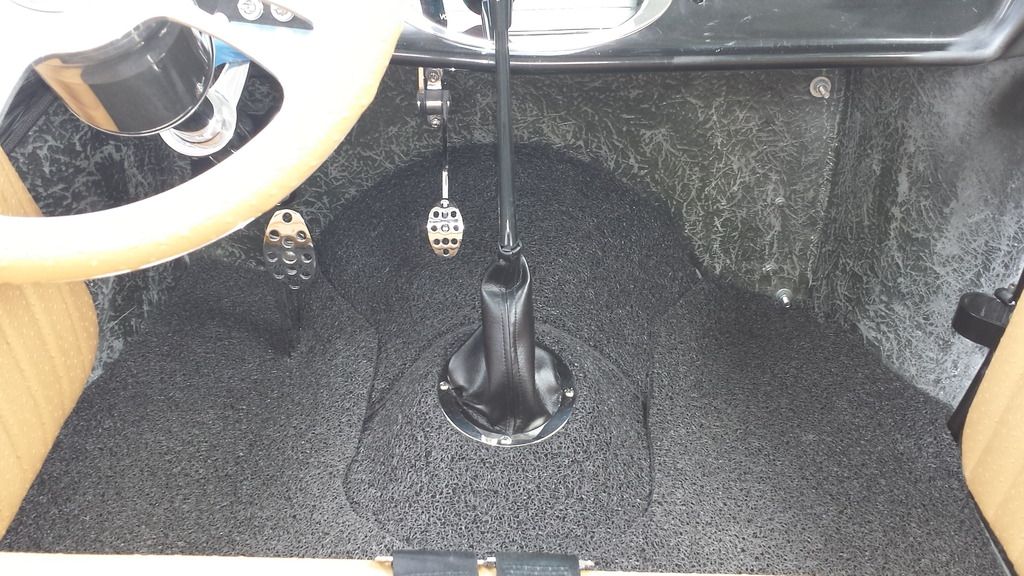

i am laying out the design of my interior and thought i had bookmarked a post that someone here has about using some sort of rubber they cut to shape for the flooring...
Can someone point me in the right direction?

interior is coming along nice. Just have the rear back pads to make.
