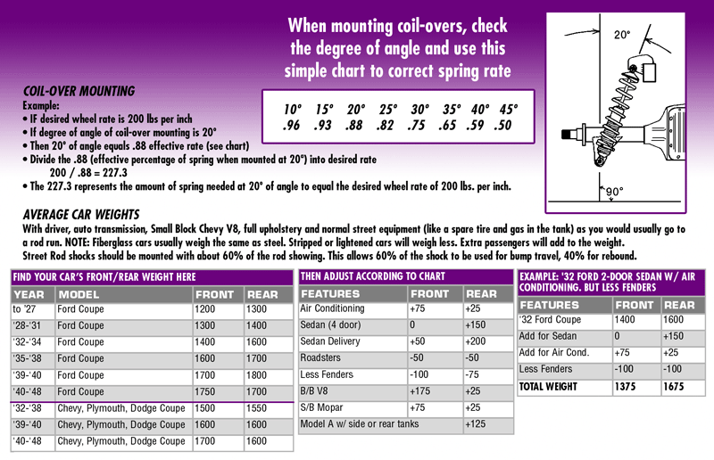

Something to keep in mind when you're placing your shocks .You're trying to dampen the vertical movement of the tire/wheel/ brake , so the closer to that weight you mount the shock , the more effective it will be , also , the more "off vertical" you are , the less linear distance the shock will travel making it less effective..

Here's a nice coil over mounting guide from Speedway. Hope it helps someone out. It's worked well for me in the past.

Fred, mine are spot on at 20 degrees and they work great.
Me too. 200 lb. springs set at 20°. And then I've two ways to adjust the load and ride height.
Obviously the spring adjustments, but also these serrated upper mounts.
My last ones were, but this go around, I'm going to be a few degrees towards vertical. Hopefully, ride won't suffer too much.
