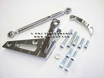

I'm thinking of moving my alternator. It's presently located on the lower left(drivers side) of the engine. Well, it just a tad close to the frame. I'm looking at one offered by Speedway. Here's a pic:
The problem might be that my upper radiator hose goes straight towards the radiator from the intake. Not like the factory outlet that exits towards the left. Has anyone used this or seen it used? Will the hose be in the way of the belt?

Fred, I'm sorry that I don't have a better picture but I can get you one tomorrow if you need one. I got my alternator mount from Speedway and I have a short water pump. It makes for a clean and simple mount that is not sticking way up in the air.
That looks good, but the bracket would block my upper hose. My upper hose comes straight forward from the intake.
Yes, I've seen a couple of these. Looks cools, mounts cool, hose, not so cool. Have 2 Options.
1. Go to Summit, they have a swivel neck, get yourself a long TIG length welding rod or metal clothshanger, straighten it out, going from your radiator to your newly purchased swivel neck, bend that welding rod to where it look like it clears. Take said welding rod to Auto Parts store, and get a couple of hoses long enough and bent like your rod. Usually I keep around some old exhaust flex tubing for this. It helps out with hoses and with doing funky pipe fitups.

So, it won't work with my hose in it's present position?
Thanks, PUTZ. I checked it out and that's what I'm looking for! Thanks to everyone who also checked.
