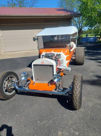

This one is for sale in Kansas, probably too far ...... It has a door and a Jag rear end/

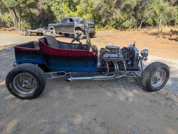

Here are a couple in the PNW. I don't do FB, but with autotempest you can search ads. Both have Ford engines.
Starter, kind of rough, but if you want to do it all.

It's a bit far, and there are things I'd change. Priced pretty high for no title, I don't know how hard it is in Utah to get that done, but interstate is only getting tougher. Still cheaper than a new rolling chassis and body.

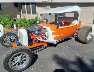

This is again a complete running one. At the price, it might be a mess, it might have most of the parts to bolt on to your own frame or it might get you on the road this year. No pics, so it's up to you to reach out.
I reached out. The price and location work well for me.
