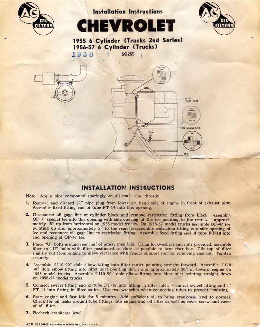

Hey. Six-Shooter, you can always add a screw on remote oil filter to your block....all you have to do is tap into the oiling system, with a send and return line, then, add your hoses and remote filter block....
