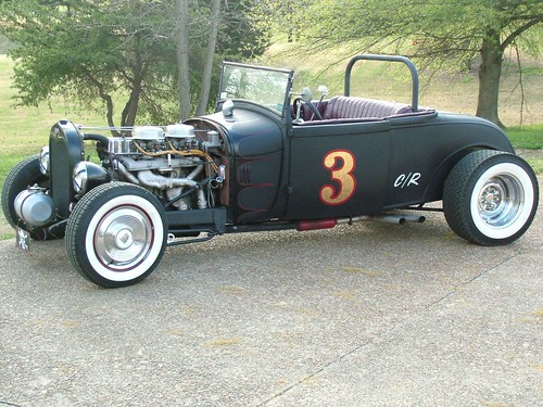

Well, it's a 292 Chevy powered Model A ... but here's the best I could do.
And just because its only got 6 cylinders.....don't think you can't make them run...........theres a few 6 cyl. records still out there.............
And you can do the forced induction systems (blower and turbos) on those motors and make as much or more than the V8s....the sky is the limit....:cool:
And the Torque..........go to a place called Inliners......they got all kinda crazy stuff there............I 'm a HAMB'er also.........check out some of the stuff there on 6's, though you gotta excuse some of the guys there though..........:rolleyes:
Thanks guys, for the photo also, sweet ride!

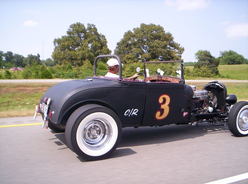

like the grille..the shroud not so much :confused:. Love the motor though! Nice bucket, but wanting a bit mush considering some of the finish.
Yeah, the shroud kind of kills the look. After seeing the potos, i'm more pumped then ever before. Good find!
Mike
