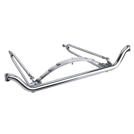

I don't see how I can swap the axle... the batwings are welded on. Drag link is about 4' and is heavy-wall DOM, about 3/4" OD. Here is my front end. It is a little askew in the pic due to the shape of the driveway.

You lost me, can't swap the axle side for side because the radius brackets are welded to the axle
Steve, are you talking to me? If so, I don't see how the front axle can fit any other way than the way it is now. If you turn it around so what is now the driver side becomes the pax side, the radius rod brackets (I call them batwings, but I know that's not exactly right) would be pointing forward and the king pin inclination will be forward. If you flip it vertically, the batwings will still be in the back, but the 4" drop becomes a 4" lift!! (and the camber would be reversed). Am I right about that? What am I missing?
No Lee I see it the way you do. Lee are you running Ford Spindles? If so, did you use the spacer for those camaro rotors?

Wouldn't this be impossible on a chromed tube axle where the hairpin brackets are welded on?
